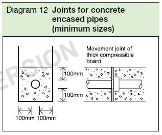

Encase it in concrete if its less than 1m below ground and in a area with vehicles.

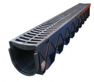

I'd like to use something like this, but with out the grates on the top:
If I encase a plastic pipe in concrete, using a 75mm plastic pipe, as per below, then can that encasement be 5cm below ground level:

I'd like to use something like this, but without the grates on the top:
Thats just what I was thinking when I read your first post to save digging a huge trench but did'nt reply as I'm unaware of where you'd get a blanking cover off the shelf to suit! :(
The problem with it is that the tarmac drive was laid over a number of years, in sections that vary slightly in height (+/- 1cm kind of stuff), so I could never really achieve a neat/flush finish, and therefore I'd still like to bury them slightly below the surface.
