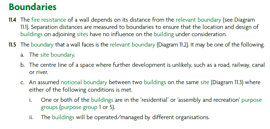

What about space separation of buildings on the same site, with a notional boundary between them?
As they are both timber buildings, over 15 sq m and potentially within 0.5m of the boundary between them, maybe Building Regs might apply?

On reflection, you might be OK building them 1m apart (assuming they are both at least 1m from the site boundary if built of timber)
The space separation regs also apply to detached buildings on the same site using the principle of 'notional boundaries' but it seems only to apply when they are either residential or under the same management - see attached at c.

It would be handy if Part B didn't apply. If I'm reading section B4 paragraphs 11.16 - 11.18 correctly I'd need 6m between 2 timber structures of this size with no fire protection in the walls [6m walls facing each other, 2.5m eaves height, area 15m2 => minimum distance from notional boundary = 3m].
