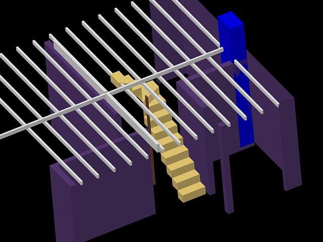

I would like to install a stairway into my loft from the first floor. The height of the loft is only 2 metres to the ridge. I do not have many options to where the stairway lands other than the centre of the loft. I have uploaded a bmp of where the best location for the stairway would be. This is not the finished design but just gives an idea where the stairway would sit in an existing plan.
As you can see the stairway runs adjacent to the bathroom and turns left before a supporting wall. The stairway is 41 degrees and will achieve the 2metre headroom limit. The only dilema I have is will I be able to support this where it is now located to meet building requirements.

Here is one possible sollution if its viable shown on this image. Turn the stairs right and attach to the load bearing walls of the bathroom and then support the ceiling with a beam's as shown underneath it's a bit more work than I plannned but could be a solution.
You realise you're highly likely gonna have to increase the size of your floor joists (increasing your Floor-Floor height) and insulate beneath the rafters too BTW?
whilst your drawings are petty they show several joists on the right hand side that are floating in mid air with no support
the ones on the left hand side need a structural calculation as you are trying to support several joists from one requiring extra support or extra strength up to or above the level required to support the weight
if you give the timber sizes spans involved along with the centres you will be part way towards getting a useful answer
your design would require walls and or steels each side off the staircase
unfortunatlly you need to involve a structural engineer because off the problems i have pointed out above
