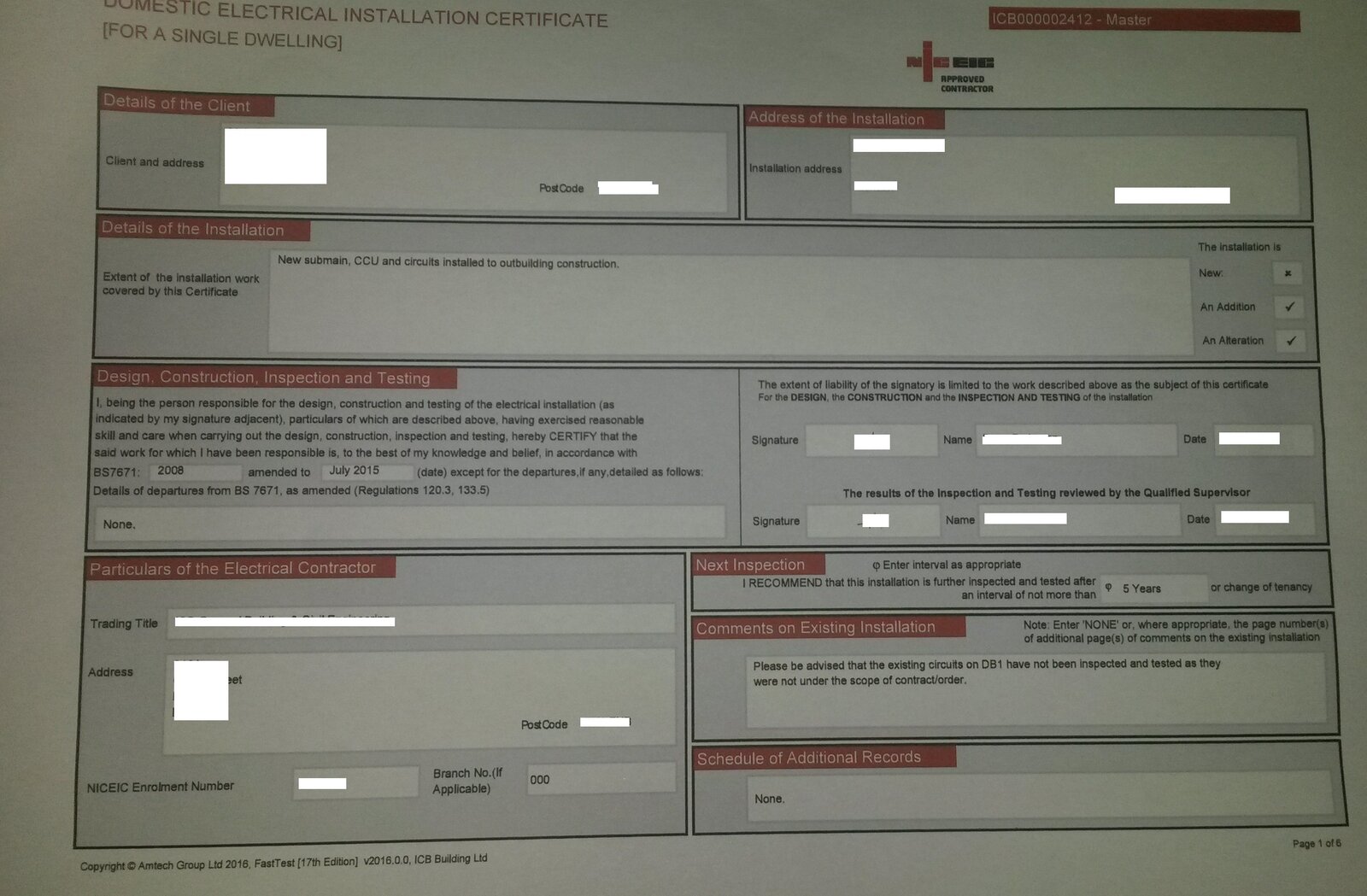

thanks, Does this electrical document satisify Part L of Building Regulations?
URL][img]
Its actually part P, Part L relates to thermal insulation.
Electrics can be self certified by a competent person (NIEIC, NAPIT, ELECSA etc), as your example cert, or by anyone else but will then require an application and inspection by building control.
