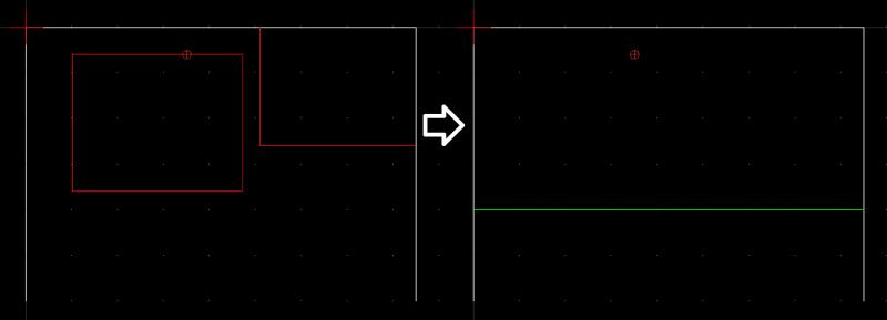

I am planning to replace my two outbuilds / sheds with one big one, to gain a few square meters of space lost in between them. One is a brick shed, places on the boundary and the other is a wood shed, around 1m from the boundary.
I want to replace it with a brick shed that is 8.5m x 3.6m (30.6sqm).
Image for reference:

If you're over 30sq.m, you need to submit a Building Regulation application.
You do not need to submit a BR application if it's built more than 1m from the boundary or is built from non-combustible material, which includes the wall and roof. Brick is fine... were you going with a flat or pitched roof? The latter with slates/tiles will provide more fire resistance than a flat roof.

Does the dimensions cover the inside or outside? From the outside (including walls) it would be 30.6, but it would less than 30 if its the internal space. Otherwise I could make it slightly smaller so it's 29.9 sqm. Are building regulations a hassle, if I decide to make it for example, 35sqm or 40sqm?
You missed the part which relates to the height of the building. Are you within those limits too?
Planning is external footprint. Building Regulations is internal footprint.
The height should be 2.5m for within 1m of the fence, I am ok with that.
It can be what you like, but the highest point must be no more than 2.5m no matter where that highest point is in relation to the boundary.
