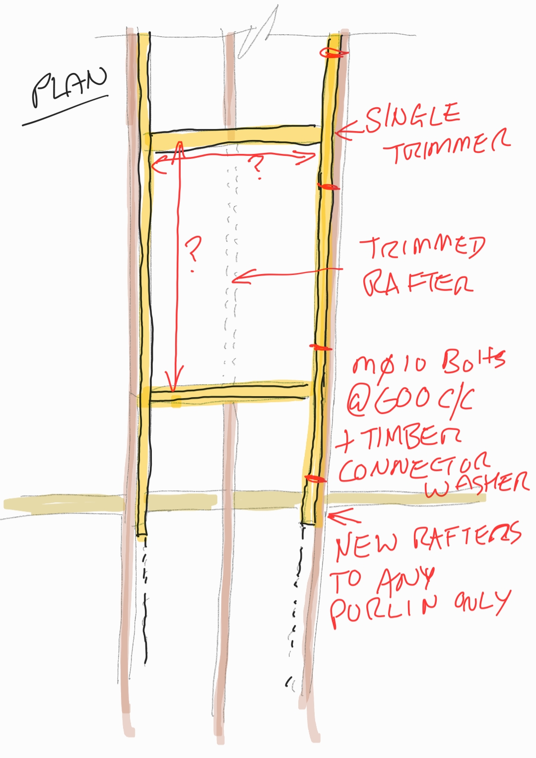

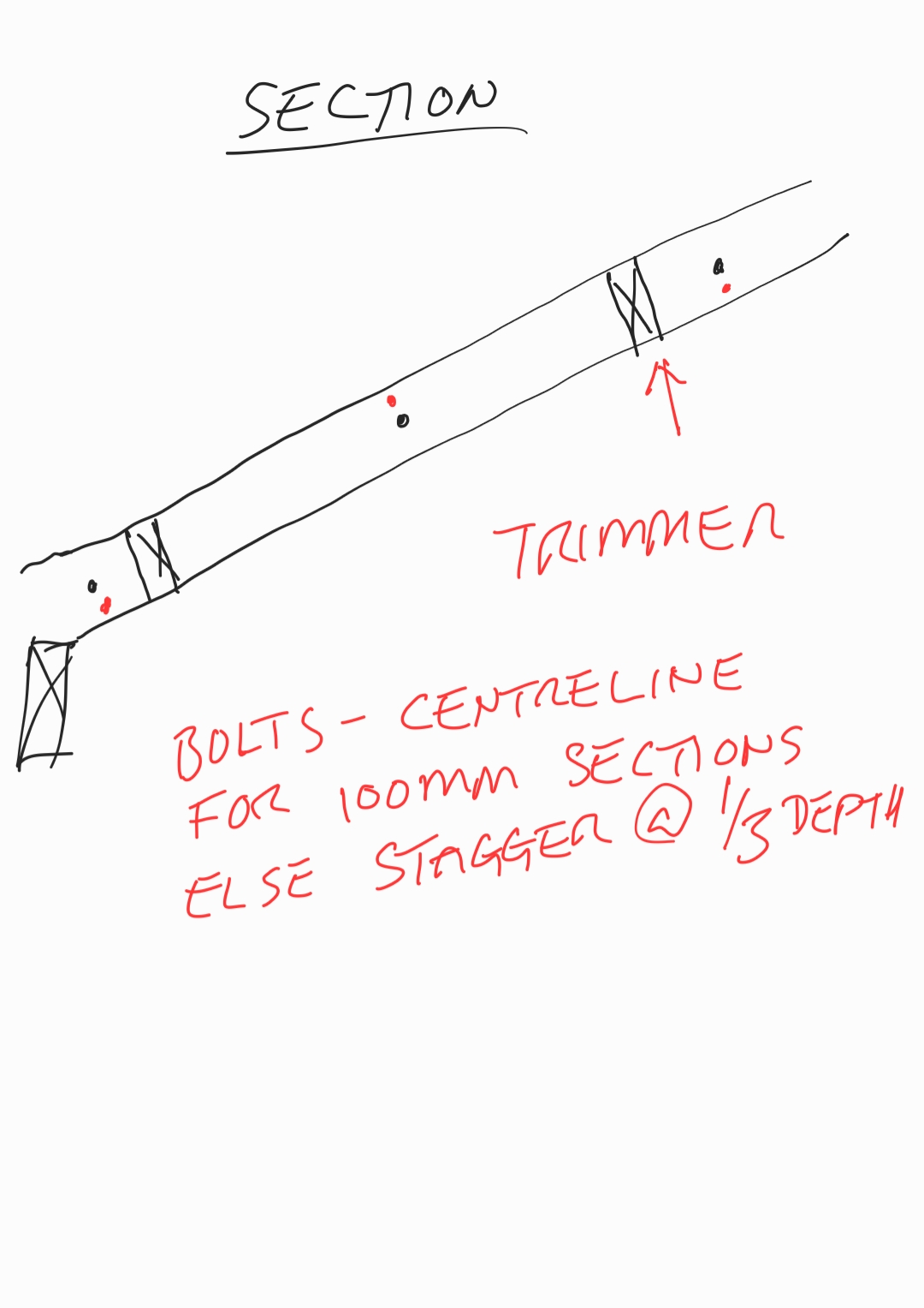

Drawings can be simple.
Awesome - thanks Woody. This is exactly what I had in mind, so could submit this as is :D :D

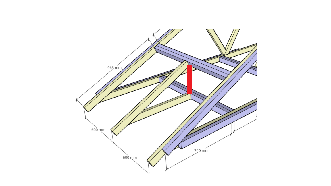

I'll share my version, for posterity and any feedback :)
I've attached my effort. I didnt do a drawing for the double-header installation as I ran out for motivation by then :D
Hoping to get it submitted tomorrow with fingers crossed.
All comments welcome/encouraged :)

One issue ... those are trusses not rafters!
Whilst it may be OK, trusses are not designed to be cut or support point loads such as trimmers.
See how you go, but the inspector may ask for design calculations.
What is happening with the diagonal truss bracing? Is that affected?
I thought top of a truss was a rafter (?)
I need to remove the short diagonal on one truss, to make the space on the roof. I don't have anything built in specifically for that being removed, if that's what you mean. Are you thinking like putting in a vertical support (below)?
