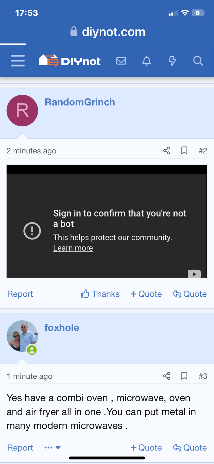

Yes have a combi oven , microwave, oven and air fryer all in one .You can put metal in many modern microwaves .
Just see this

Metal, insulated from other metal, is absolutely fine. You can leave a (single) spoon or fork, in an insulated (none conducting) dish without a problem. Two spoons or forks, etc., which touch, can be a problem. Metallic paint, will be a problem.
Contact between metallic parts, has to be very good, or well insulated. High currents and local heating occurs, where there is contact, but poor contact.
