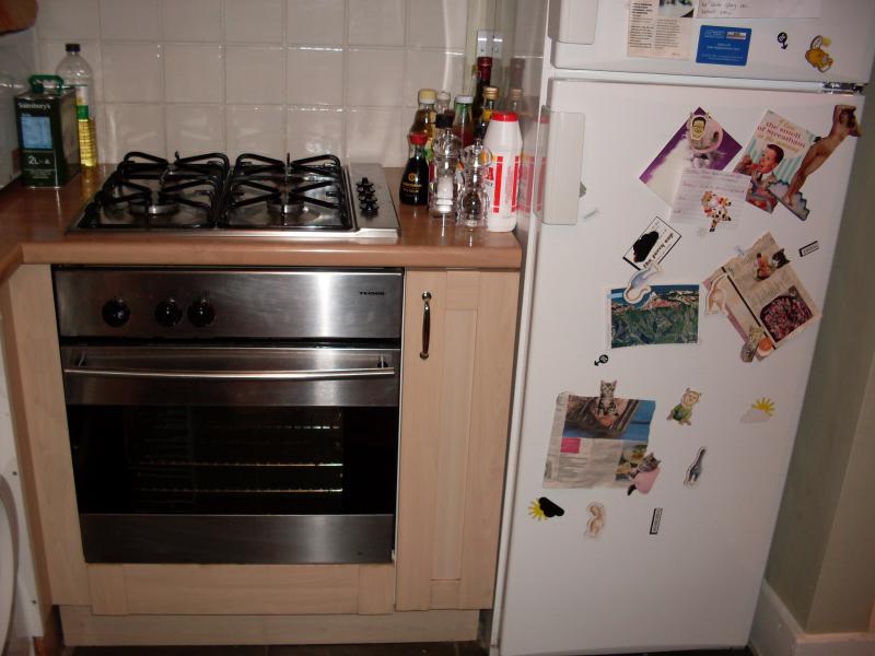

The internal carcass cavity size is
Width 570mm (this seems OK)
Depth - absolute max 535mm
Height - 705mm (without destroying the base of the carcass)

Is the adjacent cabinet of 200mm the only cupboard to that side of the oven, or do you have others? Do you know how many legs there are on the bottom of it? Also is it fastened securely to the wall as well? If it's only got 2 legs then it might not be stable enough to fit a double oven to the side. If 4 I'd have thought it'd be ok.

imroberts - the 200mm unit has 4 legs (2 front and 2 back) and the one the other side is a corner unit. Hopefully this will be OK?
I've looked at the gas pipe and I think it should be fairly simple to re-route - got a man coming to check it out. That way I'll have 560mm of depth to play with which should be enough. The 'cut out' on the rear of the ovens should just be enough to accommodate the gas pipe bend up to the hob

Checked out the side cupboards in more detail and discovered that actually there is no unit to the other side of the oven (the 'leg' I saw is in fact for the oven unit). This presents a problem!
The space is a corner space, it looks like the work top is supported by battens on the wall. Not entirely sure how you'd get a side piece in which would be suitable to support the new oven.

OK - more sensible suggestion - do you know any kitchen fitters who can stand upright who you could ask to look at it and give you ideas?
Pictures would help.
I can't see it being a massive problem, you just need to beef up the fixings for the existing cupboards.
It's amazing how strong a whole kitchen becomes, when they don't seem to to be very strong on their own.
My built-under double oven stands on its own legs. It is not supported by the cupboards either side, but it is fastened to them.

Pic here: The cupboard to the right is 200mm and has 4 legs. The 'cupboard' to the left isn't a cupboard, just a void which doglegs round to the washing machine (just seen)
