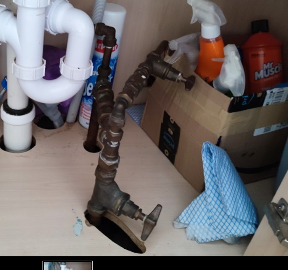

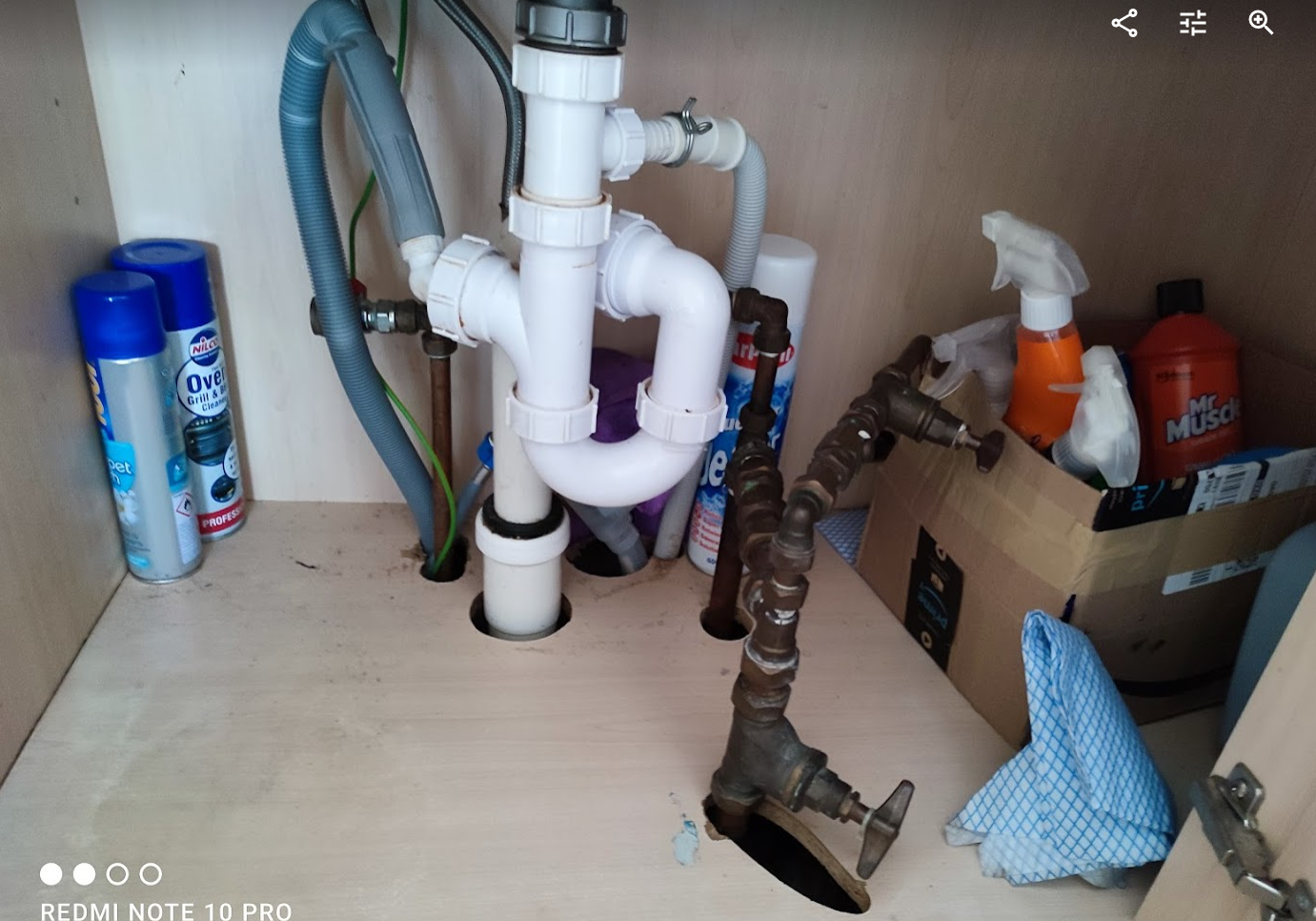

Hello everyone,
We will be installing a new kitchen and would like to simplify somehow the piping under the sink (see attached pic for what we currently have).
The brass pipe in the pic controls the water in the house and also an outdoor tap, but it's very bulky and takes up most of the space below the sink (I've never had one like this in my previous houses). Is there any way of making it less intrusive, move it to another place (to the back of the cabinet? in a kitchen corner? in the cupboard under stairs?), or replace it for something that takes up less space?
Any suggestions or ideas would be much welcomed.
Many thanks.

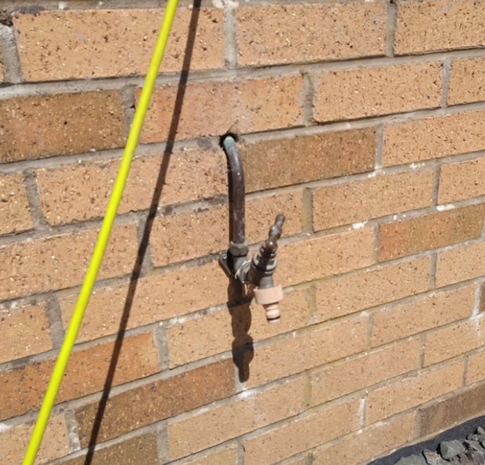

Thanks, Madrab. Where can be moved, exactly? Is this the outdoor tap you're referring to? Thanks.
Yep, you need to be able to shut down the mains supply to that internal mains stop tap, that'll allow all that pipework under the sink to be cut and moved to a more suitable location.

Brilliant. Sorry, so I guess tha main stopcock you're referring to is the brass one from my first post, right? Is that a normal shape for it or can it be replaced for something simpler that doesn't need so many holes in the kitchen cabinet?
It can be replaced by a lever style one which shuts with a 90 degree action.
The lever can be dismounted so you'll only need a small round hole in the cabinet, then refit the lever.
Make sure you get a good quality one, so it's less likely it will leak or get stuck.
