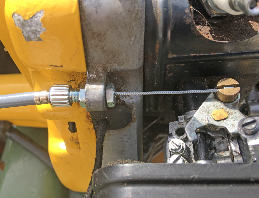

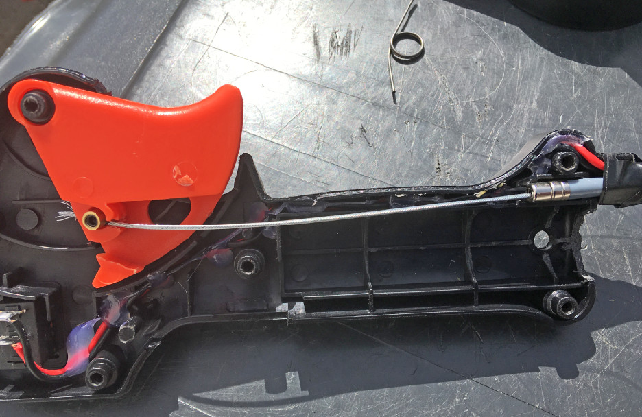

Hi,
I ordered that short cable we spoke about and put a solderless nipple on the other end.
Please can you look at these 2 supplied photos.
With the adjustment screw right up against the housing the outer casing of the cable is sloppy.
As you can see now i have the adjustment right out the sloppy part has gone and operates fine.
I wish to have the adjustment screw in to the housing as opposed out where it currently is.
So if i put the adjustment back do i then need to pull the inner and the trigger end through a little more.
I thought that this would be the answer but then i told myself i would just be operating the lever on the carb,
Now i have confused myself as to what i need to do.
