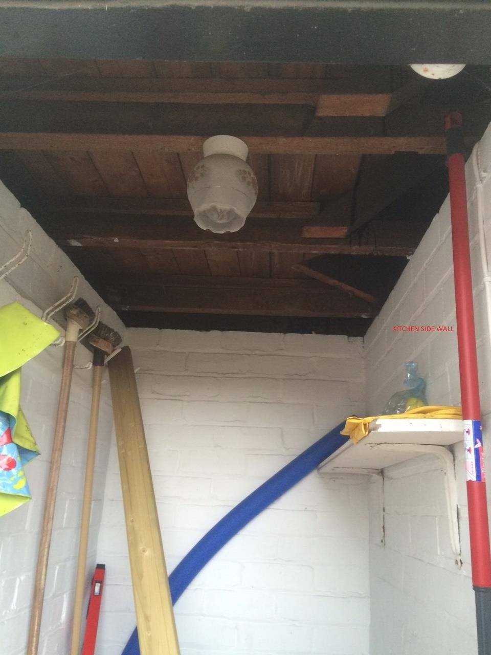

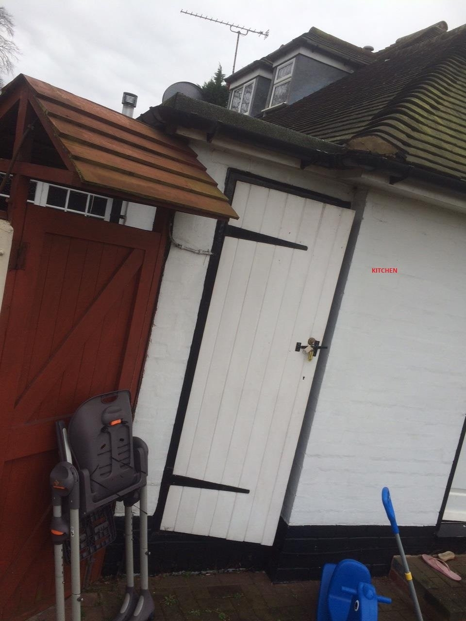

Kitchen is FREEZING! It is always much more colder than the rest of the property. There is a small utility room which links to the side of the kitchen, this utility room has a flat roof and is not installed inside at all. Am i correct in thinking the cold seeps via the flat roof and into the cavity = freezing kitchen? See pictures:

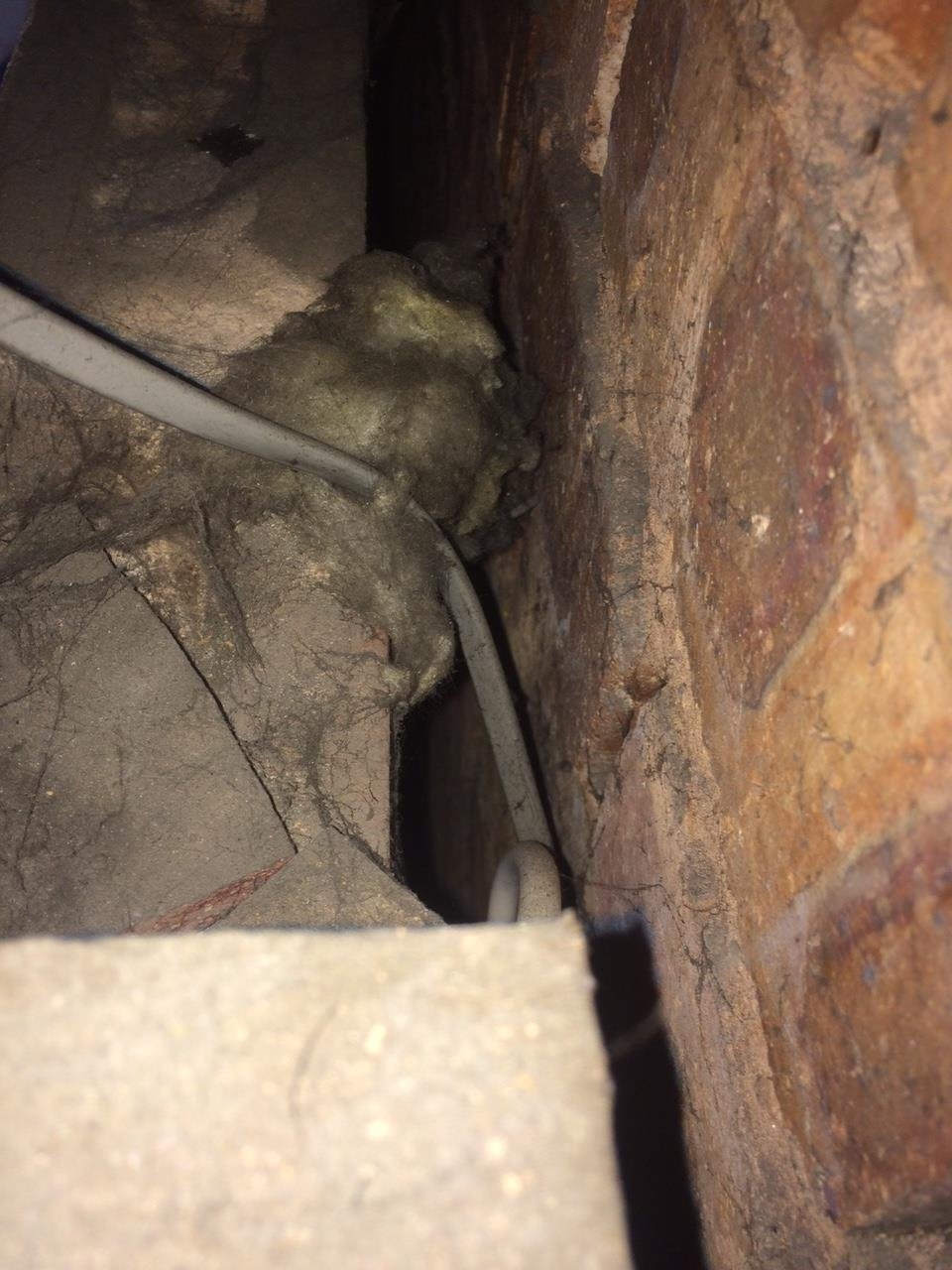

Pic below showing open cavity between utility room outside and the inside kitchen wall.
full

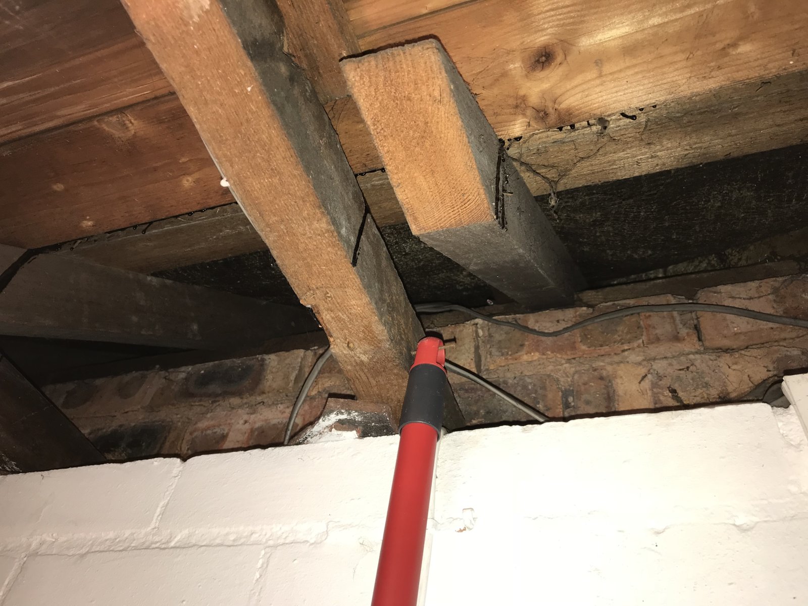

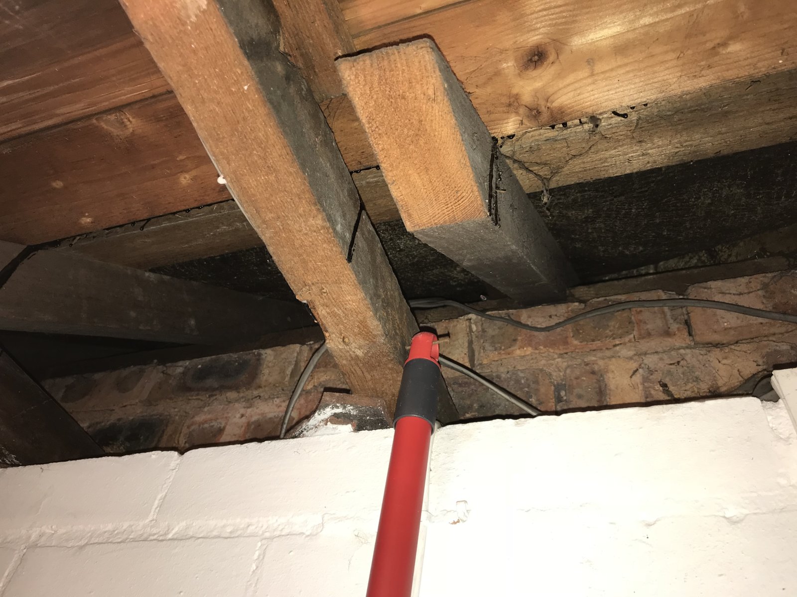

Pic below showing the roof of the utility room and the wall of the kitchen.
full
My other question is about the top of the cavity wall, is there supposed to be a cavity closer? I THINK the cavity is open around the bungalow - is this right? Should i get it covered with installation?
Sorry for the mis match of questions etc.... got too many things running through my head.

The flat roof looks like it is open to the cavity so that isn't helping I'd expect the gap between the rafters to be filled with bricks or celotex type insulation.

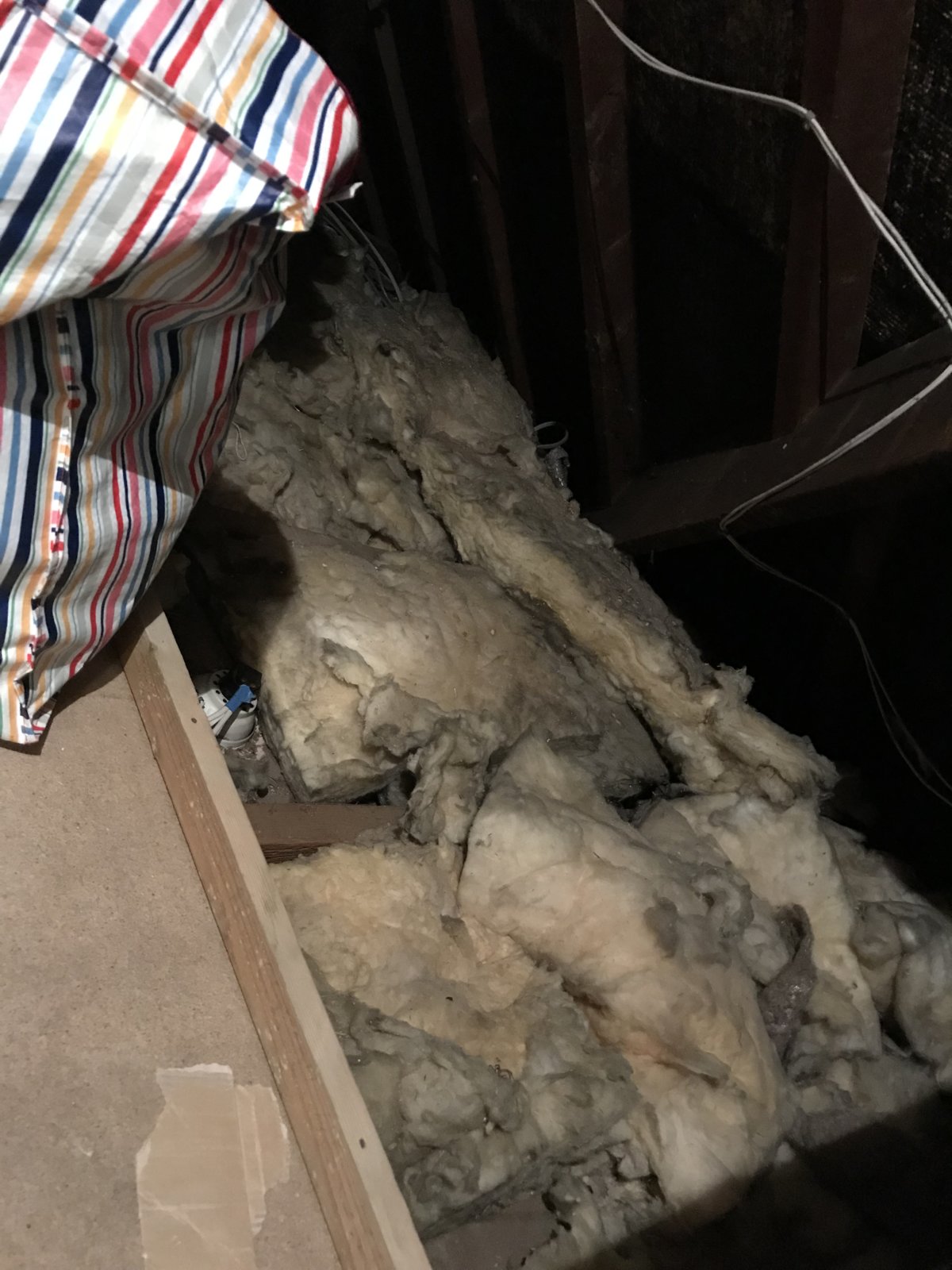

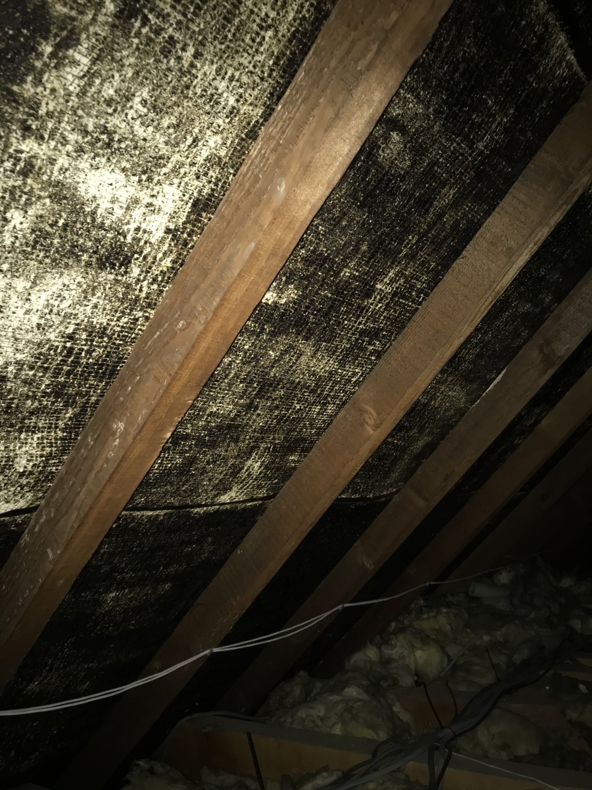

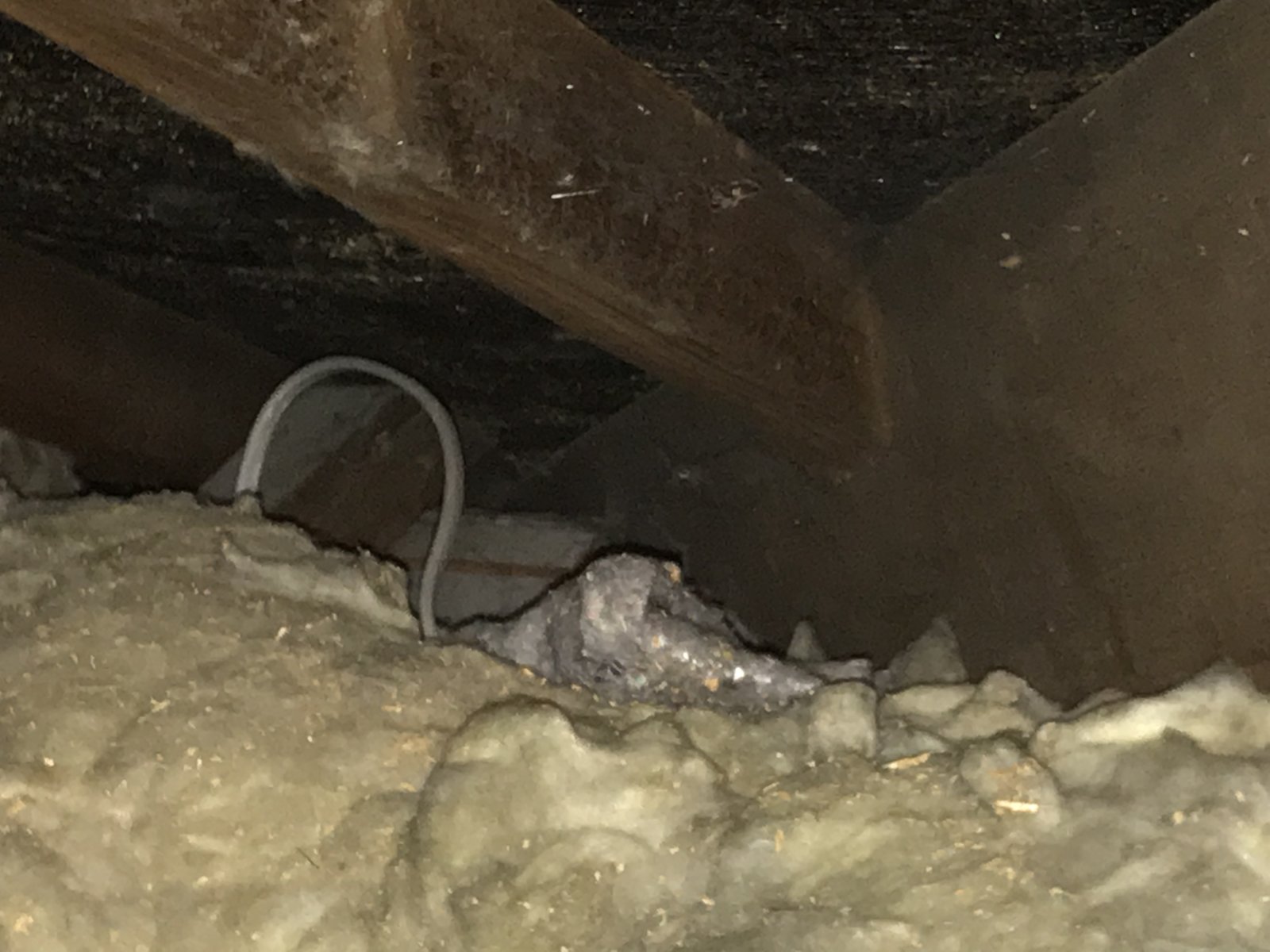

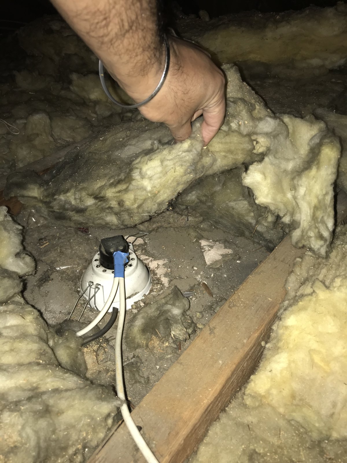

iOS Image - 2795123379.jpg iOS Image - 923875757.jpg iOS Image - 3711855076.jpg iOS Image - 46190233.jpg FA9836D3-EE7A-4807-B019-4E3F82AF7427.jpeg Taken a few more pictures.

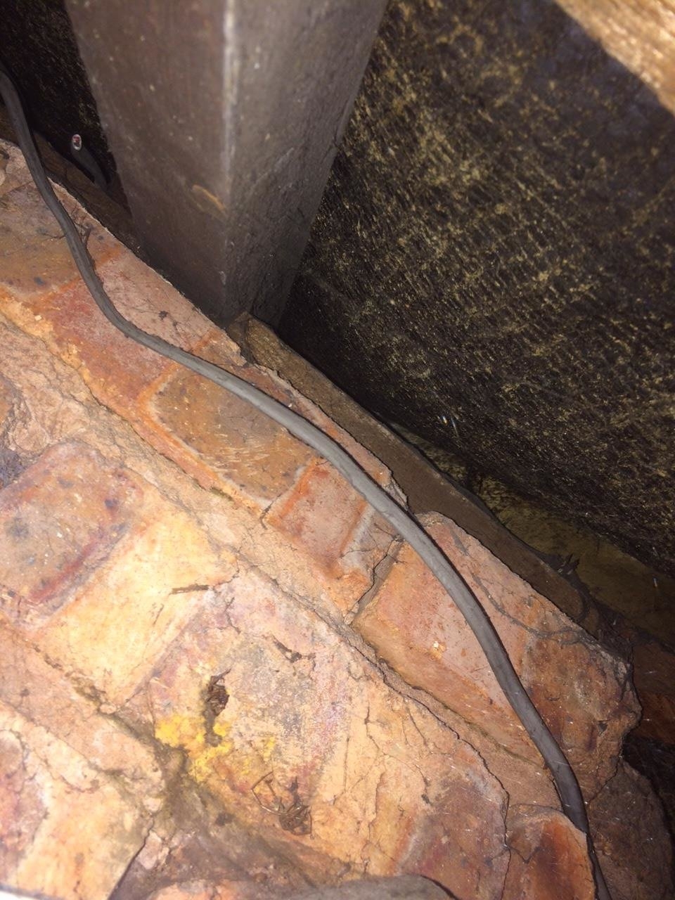

So the short pieces are from the main roof, then come down and sit on a piece of wood on top of the inner (kitchen) wall.

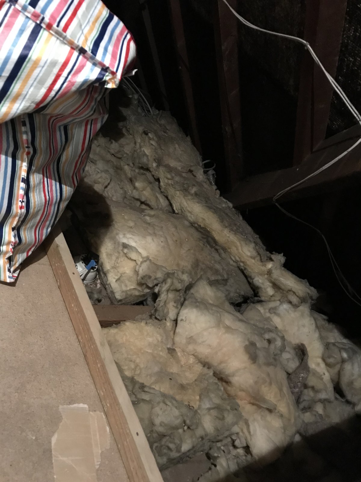

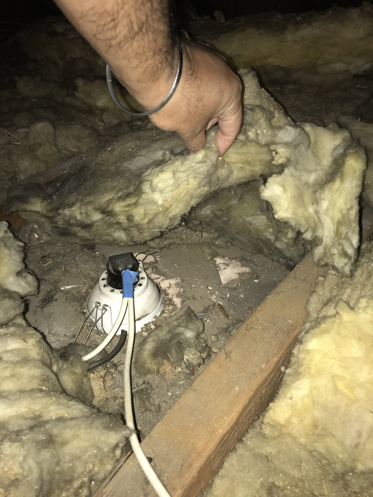

I went up to the area directly above the kitchen ceiling via a hatch in the extended dormer section...
This is the type of insulation it has, I take it that it needs replacing? Also the insulation is in patches and missing in certain areas.

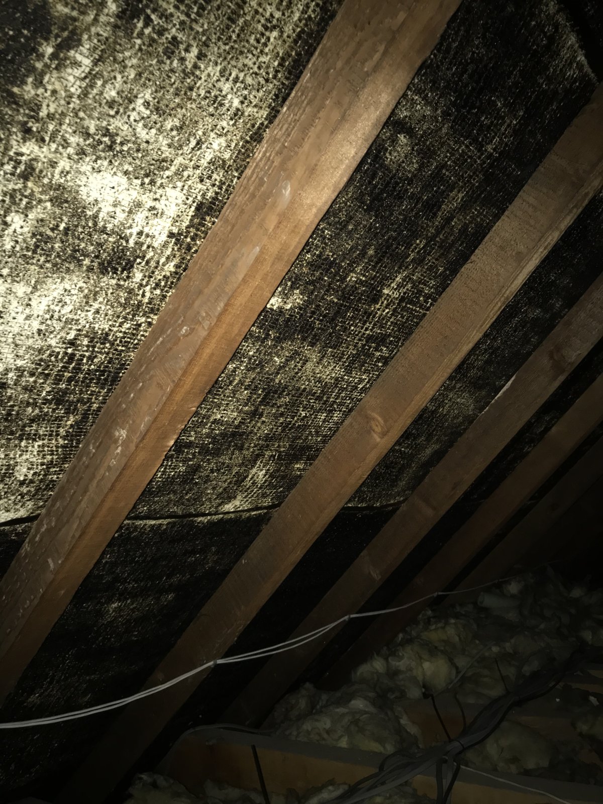

The roof has a black type material and then the tiles. No insulation, is this the way it should be?
Thank you
Its the way it was with your type of property 60-70yrs
ago, its not the way it would be by today's standards.
Right.
What would be the way forward from here then?
Any views of getting some kind of grant to replace the insulation?
