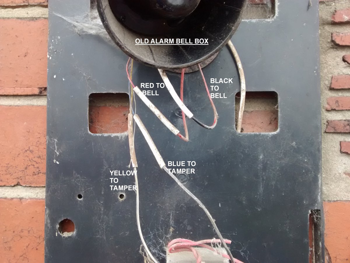

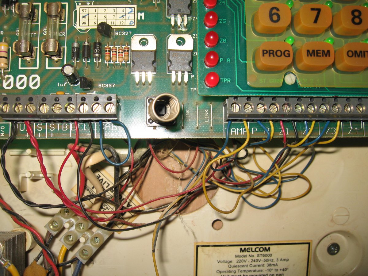

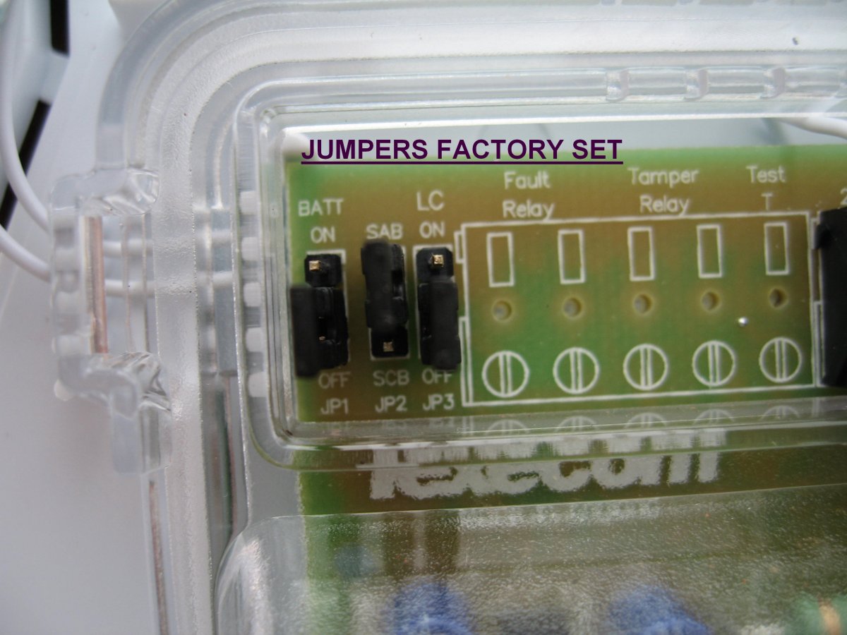

Ok i have an old Melcom st600 panel and a very old bell box that stopped working 2 years ago so i decided to change the bell box as it was crumbling off the wall (picture supplied). I swapped the old bell box for a Texecom premier 1E and wired it up but this is not working as well, i have a 4 core cable and was told to put the red wire to the 12v and the black to the bell, then use blue and yellow for the tamper (picture supplied). Melcom st6000 picture also supplied. I have checked the 3 fuses in the Melcom ST6000 panel and all ok, so I'm a bit puzzled.

Remove the blue link and replace with the yellow and blue wire from bell box
Now try bell box and if rings all ok.
You could then put a wire link in bell box between bell trigger and strobe and strobe will then flash when sounder rings.
If you still have a problem you will need to check that you have 12 volt at panel between bell + and bell - when you set alarm off.

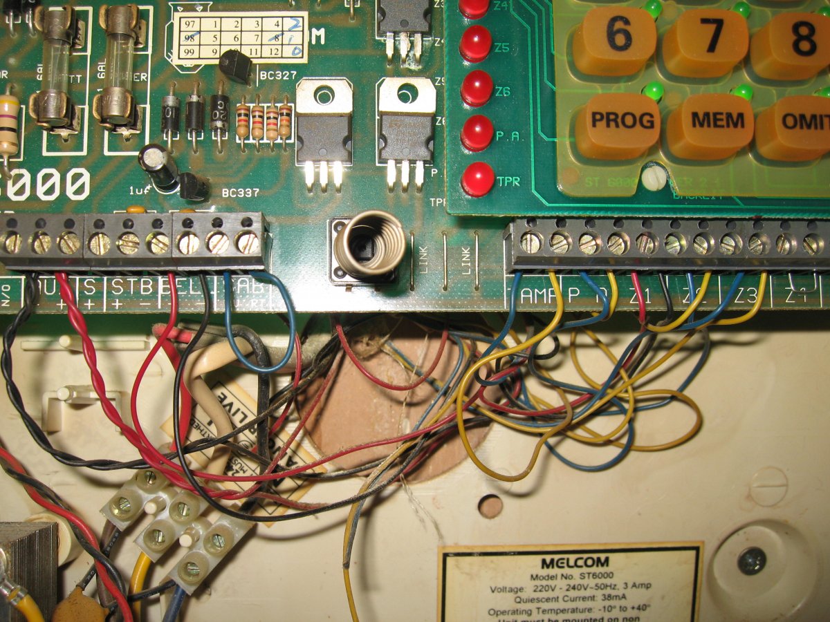

Ok Handymanjo, do you mean the blue link (SAB) on the Maxicom ST 6000 and are you happy with wiring on the bellbox.
OK great, do you mean the blue link on the Maxicom ST6000 and are you happy with the wiring on the Bell box.
If the bell box now works correctly you can now put the black jumber in the bell box from batt off to batt on.
Do not do this untill you are happy the bell box is working correctly otherwise when you power the bell box down it will ring outside untill timer cuts off.

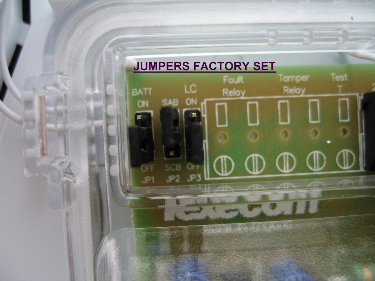

Ok, so you mean move the black tab from the bottom two terminals to cover the top two terminals on the BATT, also should i put the LC tab on the bottom two terminals to the top two terminals if so what would this do?
Yes
Link on top 2 makes battery live in bell box
You can put jumper on bottom 2 LC
This mean low current.bell box user less current when ringing
