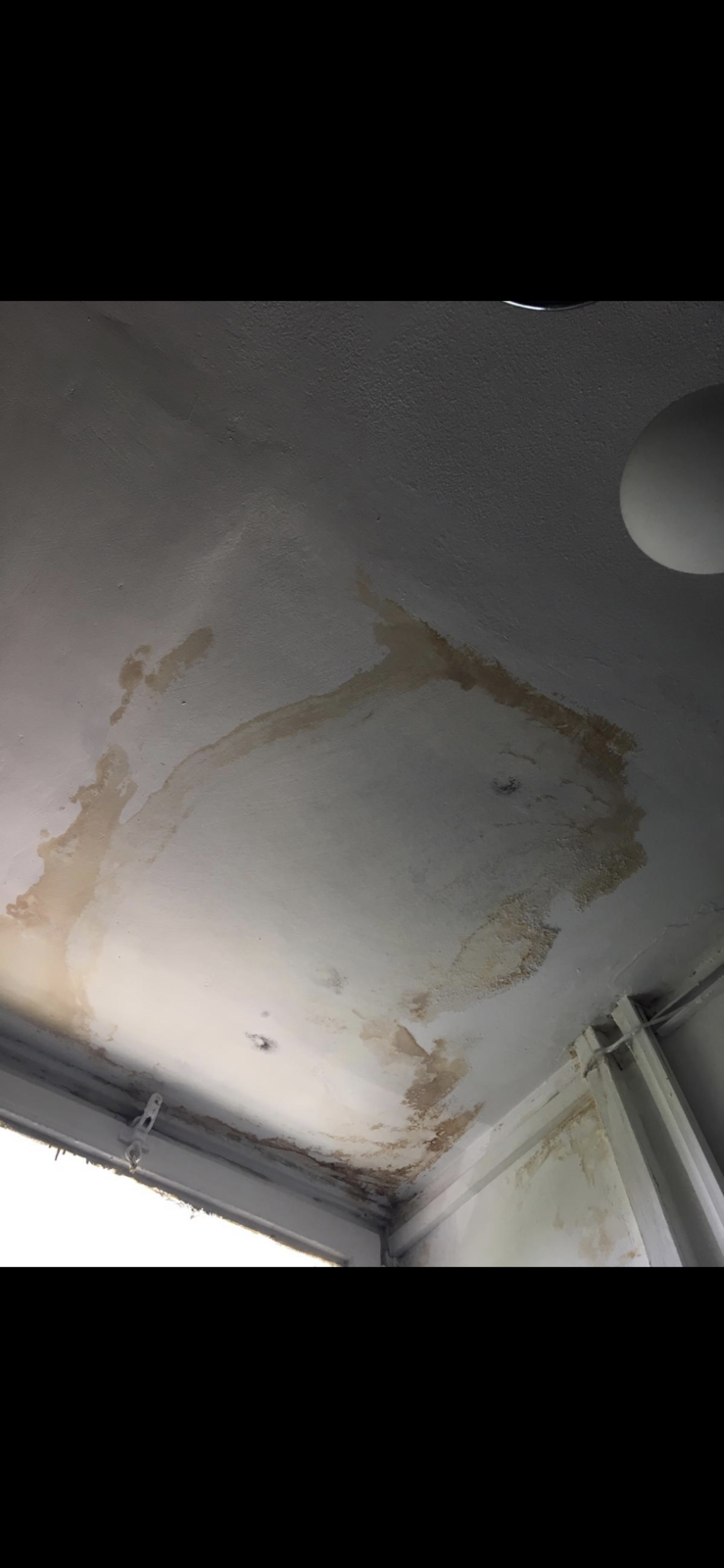

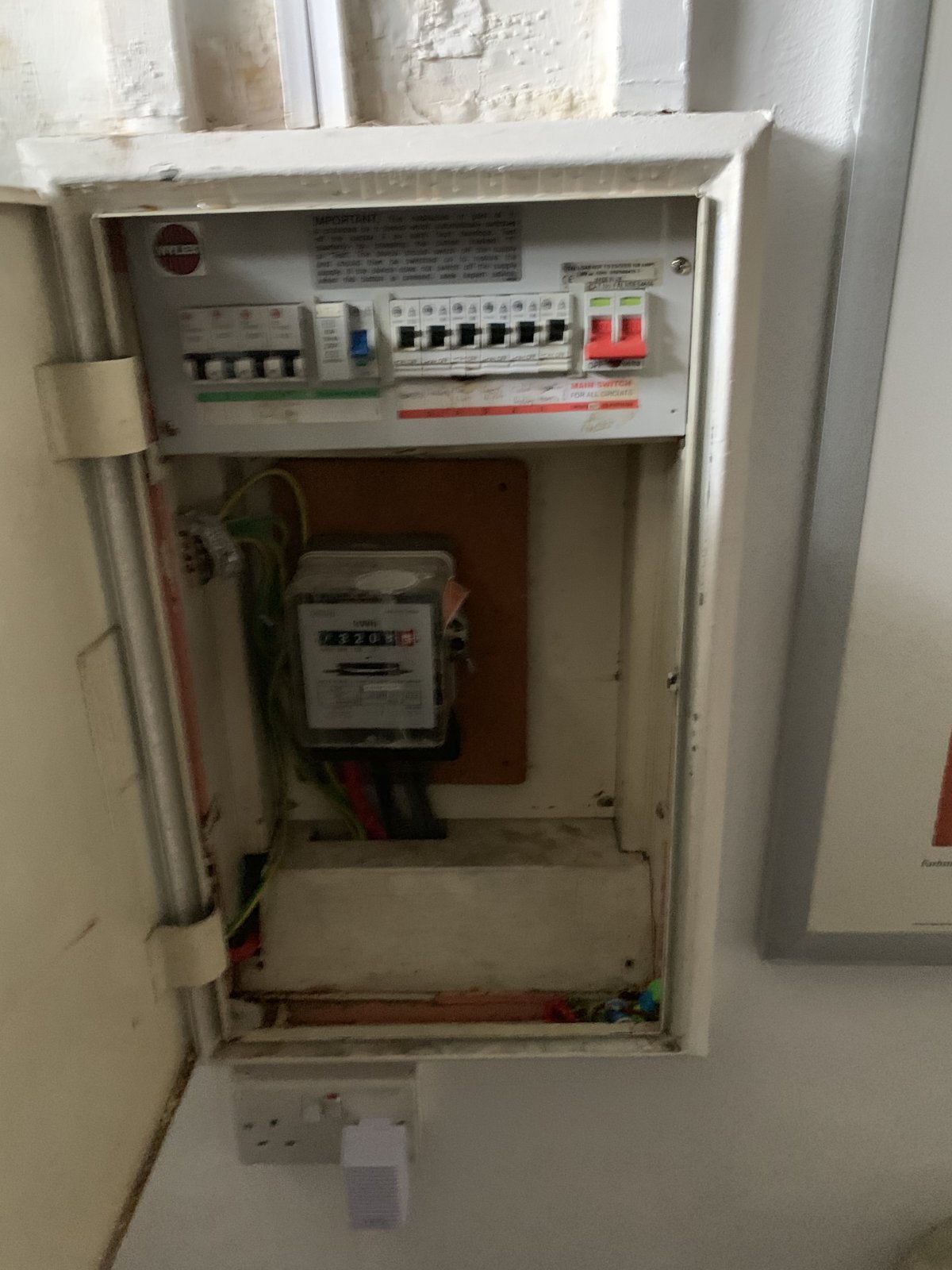

I woke up at 3:00 am today to burning smell and sound from electricity meter. Immediately i pull down the two red switches to switch all electricity in flat off.

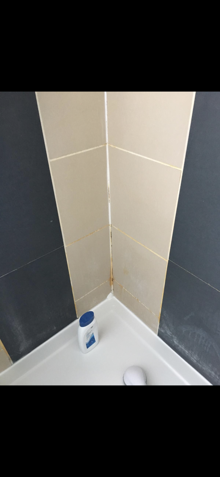

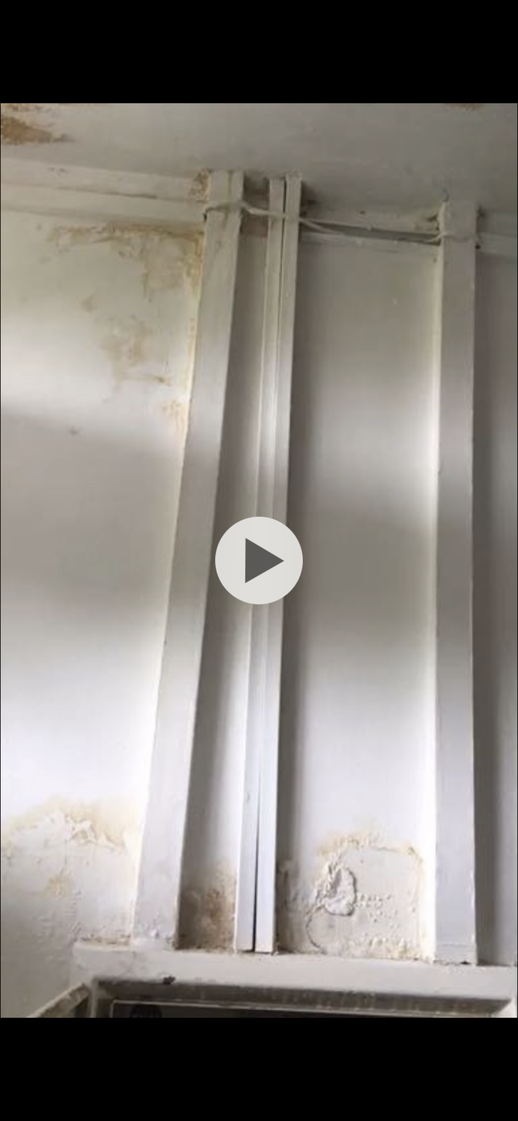

i have attached few images. Also directly above the meter unit is our bathroom. I noticed a damp ceiling, wall around meter and water inside meter as well. We are on the top floor, nobody above us. There is a pump shower installed in bathroom because of low gravity and poor pressure from shower.
Hopefully someone here can advice, enlighten me for the damage and cost.

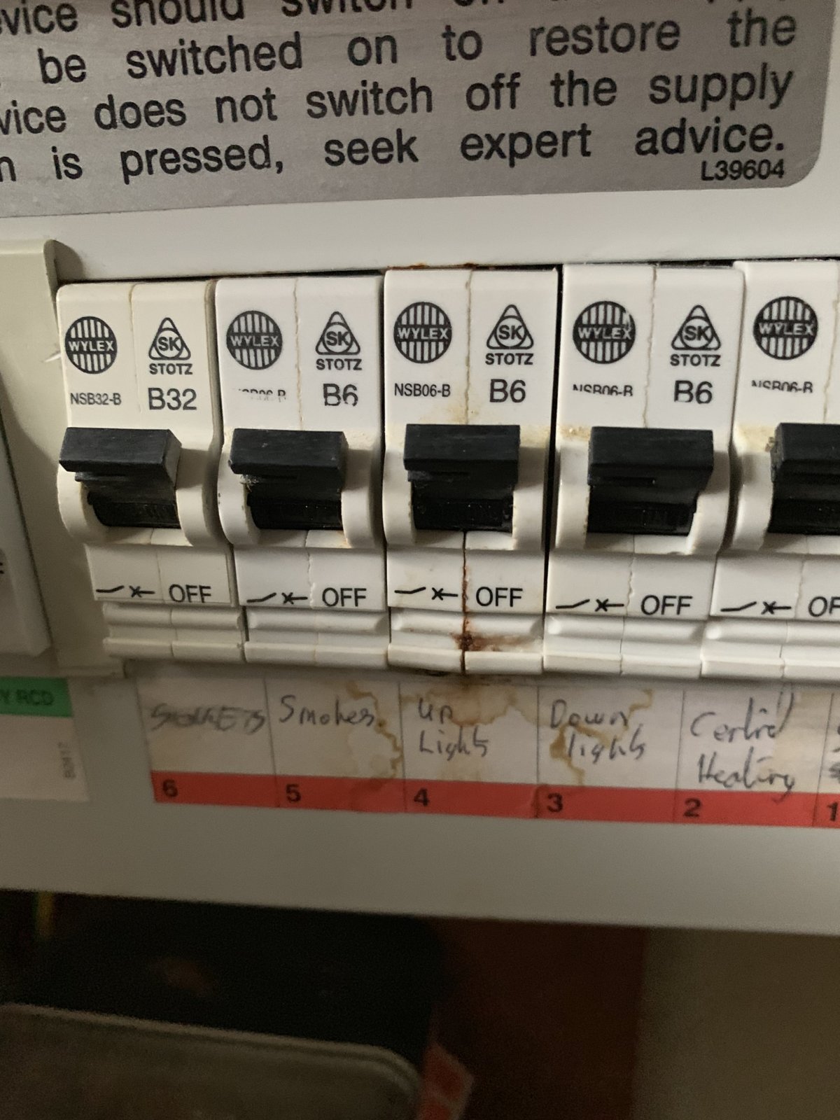

One guy said first of you have to drain the water stored in ceiling, give it 42 hours and the deal with electronics, you can see black mark under the third switch.

Looks very much like your board has water ingress too, the MCBs might be ok but most likely need replacing and since it's split load the ones in your photograph aren't served by the RCD to the left. The Meter is pretty old so your DNO may well replace that for a Digital one. It's pretty difficult to give a figure without further investigation but I'd think at least a three figure sum.

Is that the electricity meter that someone comes to read, or you submit readings from? Just surprised there doesn't seem to be a service head of service fuse nearby? I'm very surprised they won't come!
