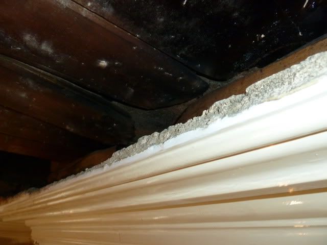

Today i took down my lathe and plaster celing ready for a new ceiling to be out up and above my fireplace we noticed that the wood that looks to be holding up the stone hearth upstairs is burnt and black.
How can this be. Is it anything to worry about?
I have put a pic below for any advice possible?
Thanks all
The picture is not clear - is it the floorboards which are black, and do they go into the wall?
Is this just black soot or actual charring?
And do you use the fire in the room above?
drag a blunt instrument across the boards like a screwdriver if it drags off the more than surface depth its charred
if the damages is less than 2mm then it may be coating rather than charred wood
You should have something like this to support the hearth. Flues are more likely to leak between floors or in the roof space as there is often no render over them and also the leaks are less likely to be spotted. The fact that soot is getting on to the joists is telling you something about it's condition.

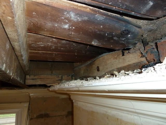

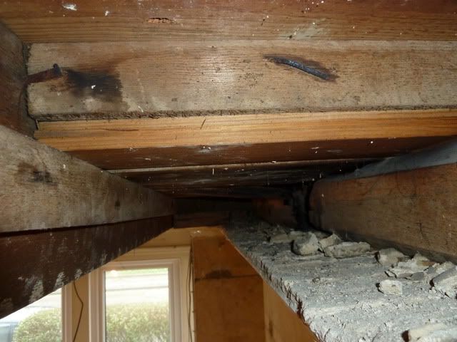

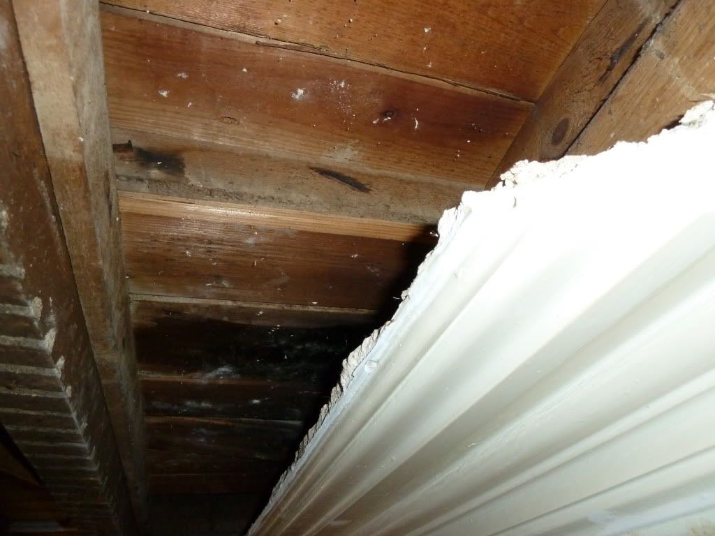

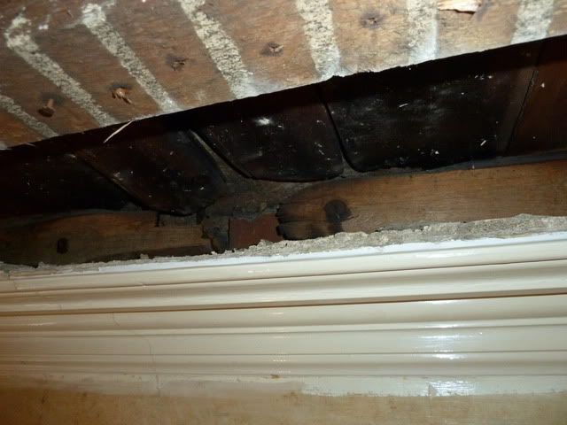

its not the floor boards that are black it looks like skirting board that may have been added after but i am not sure why its burnt.
i have added some more pics to aid in seeing what i can see.
i could put them away and see the concrete slap (hearth from the bedroom).

I took the advice and got an expoert in and he looked and said straight away there is nothing to worry about.
The flue for the down stairs chimney would not be there as it goes to the side as the bedroom fireplace is above.
He said the reason the wood is scorched is that the bedroom fireplace has been run far to hot in the past and has caused the wood to smoulder and over the years burn away.
the hearth from the bedroom above is only 2inches thick and not thick enough for excessive heat.
He recomended to fill in the hole that the wood above was resting on with concrete and i can either remove the hearth or just re support it with new wood.
or just remove it.
