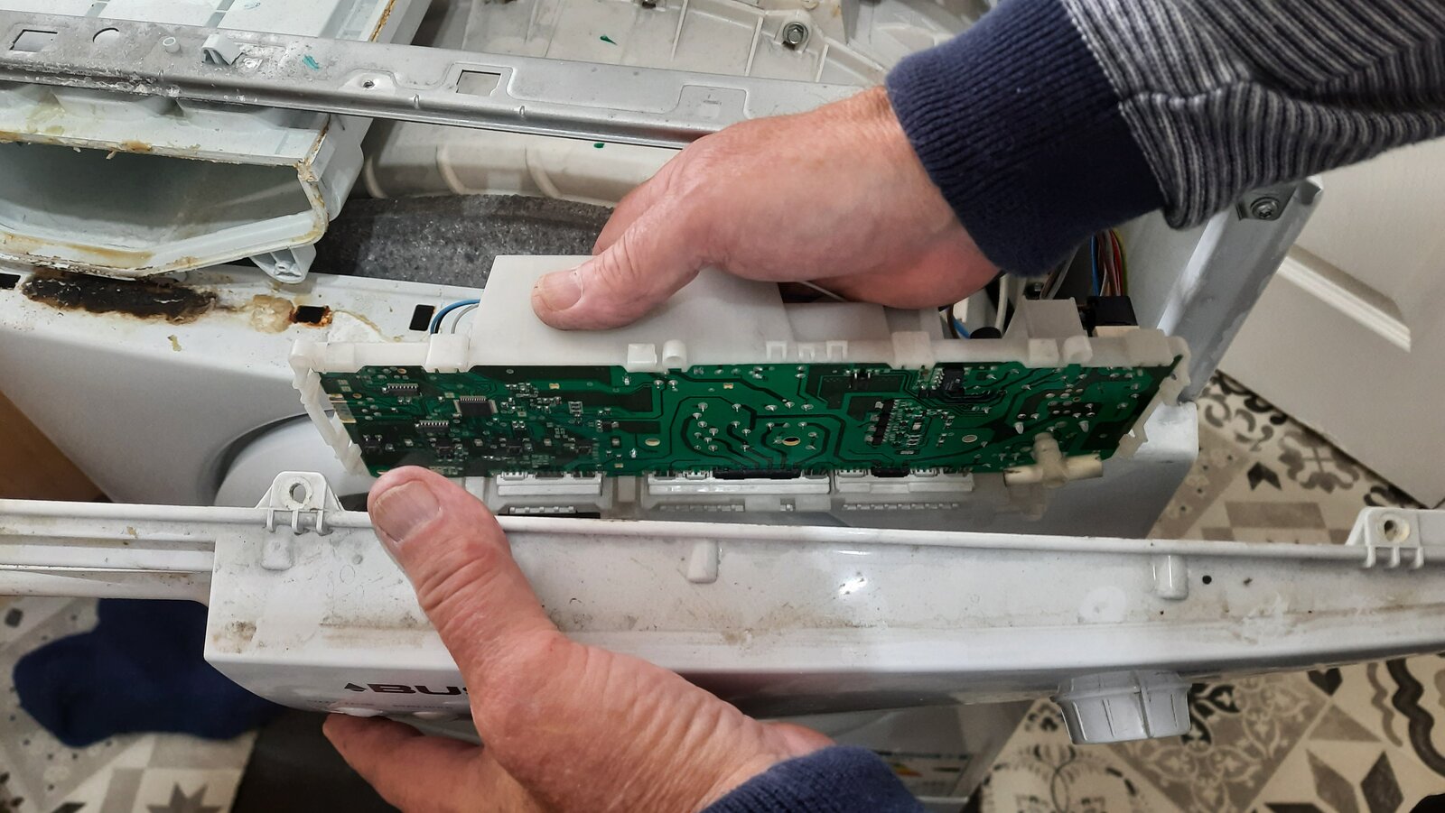

Hi, I have a Bush A127 QW washing machine that was working fine until I started having problems with a sticky start button. I've ordered a replacement button strip and I'm looking for advice/guidance on how to remove the top of the machine and how to access and replace the button strip, please.
Try taking some photos of the rear of the unit. You might need to remove the detergent tray from the front. The top should have a couple of screws from the rear that will need to be removed. Once the detergent tray is removed, see if there are any hidden screws that may hold the top down. Hopefully you should be able to remove the top. Take caution when removing the top as cables may be fixed into some grooves as a form of cable management.

  6. The PCB is in a plastic housing that is a push fit into the front panel. (See Pic 1.) Pic 1.jpg I was very careful not to touch the PCB and I had to use quite a firm pull to separate the two (probably the most scary part of the job). Once separated, the front panel is entirely free to come away.

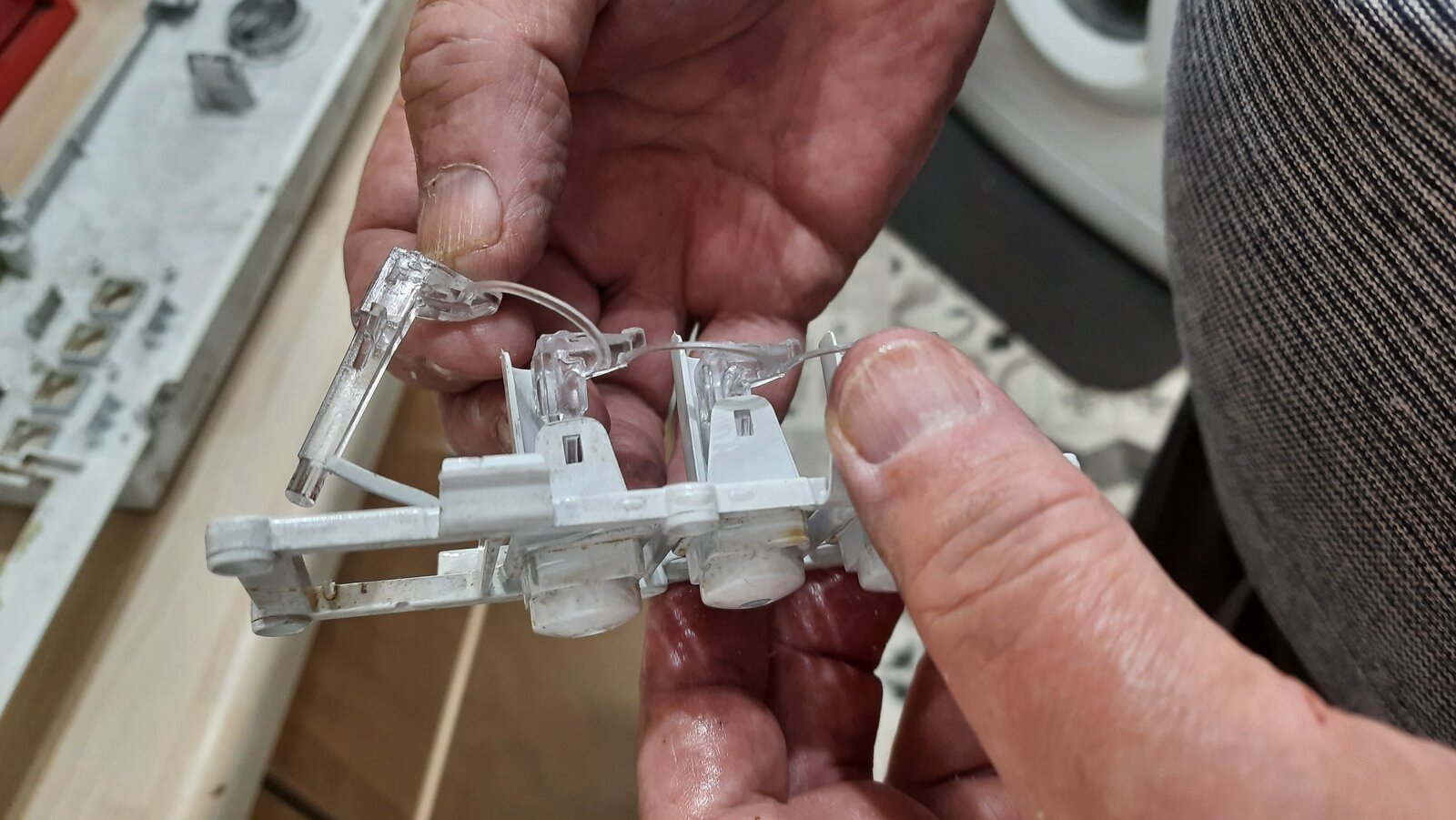

  7. The button strip is a push fit into the front panel and I gently levered it out. It has a strip of 4 clear plastic probes that connect the buttons to the electrical switches on the PCB. These are, again, a push fit into the buttons and have to be carefully removed to be re-used with the new switch. (See pic 2.) Pic 2.jpg
  8. I cleaned the front panel down and clicked the new button strip and the re-used probes into place.
  9. I then cleaned down the inside of the washing machine drawer area (residue of old soap powder) and brought the front panel roughly back into position. Being very careful not to touch the PCB itself, I clicked the PCB housing back into position on the front panel, making sure everything was firmly in place but not using too much pressure.
