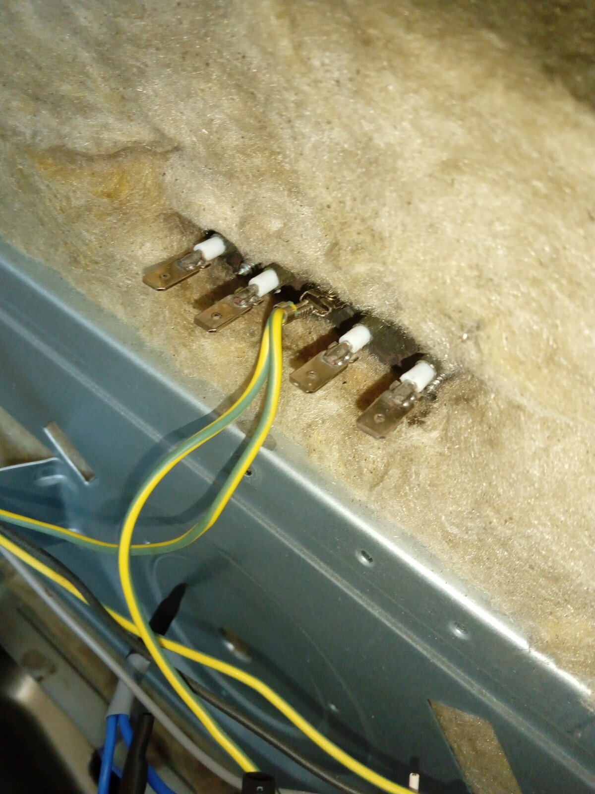

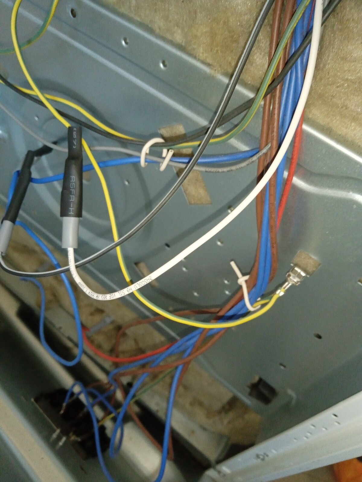

Hello All,
I have an issue with my Bush oven. I brought a new top grill to replace the old sagging one. I hooked it up & turned it on. It started heating up but at around 30 secs-1 min it tripped the electrics. Im just looking for some advice as i think i hooked it up correctly but I'm not sure as when i took the old element out i forgot to take pictures. I thought it was a push fitting connection but i was wrong.
Any advice you can give me would be much appreciated
The replacement element wasn't new i brought it as used, but it looked fine with no damage.
First of all - what exactly is tripping?
If you do not know, post a picture. Just copy and paste or drag.

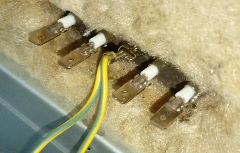

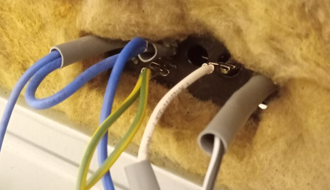

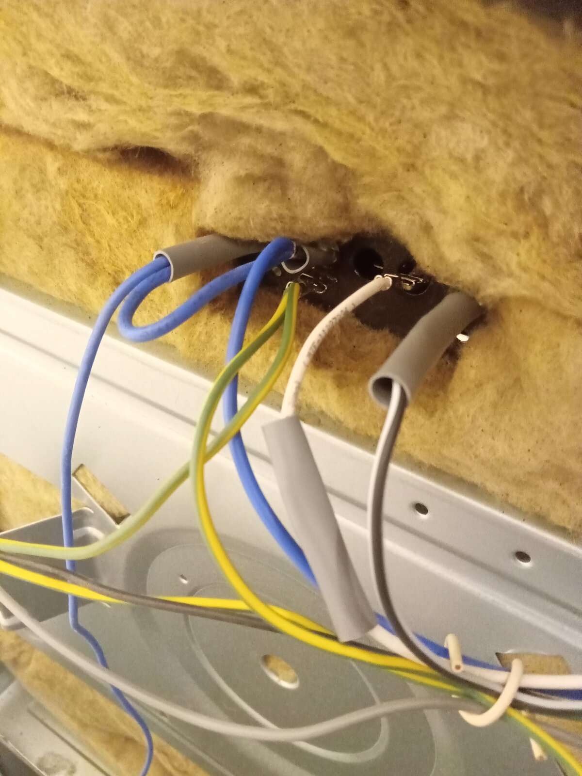

The rcd on the fuse board is tripping. I have uploaded some photos showing the wiring.

Well, this looks right - when the earth wire is connected to the middle connector.
So, if that is what you have done, then I suspect one of the elements is faulty.
The blues should be on the left two.
The white and white/black on the right two - can't tell which which way round.
Thank you mate for quick reply. Yes i thought the wires were right so i guess its a faulty element grr. It teaches me not to buy a cheaper used part lol. Thank you for your help
