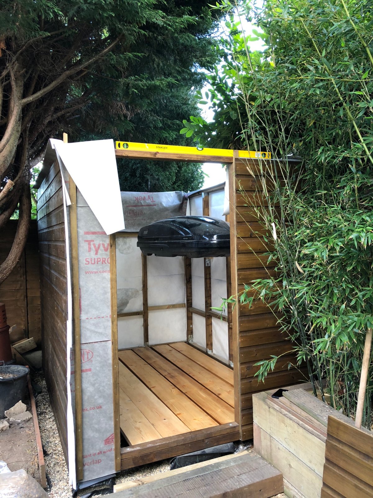

Hi all,
I now have 4 walls in the shed (picture update attached!) and have made up a door for the opening. I was originally looking to put T-hinges on, but the ones I bought had a *lot* of play in the hinges, to the point where I was very dubious, and I've now acquired some stainless steel fire door butt hinges that I'm hoping will do the job instead.

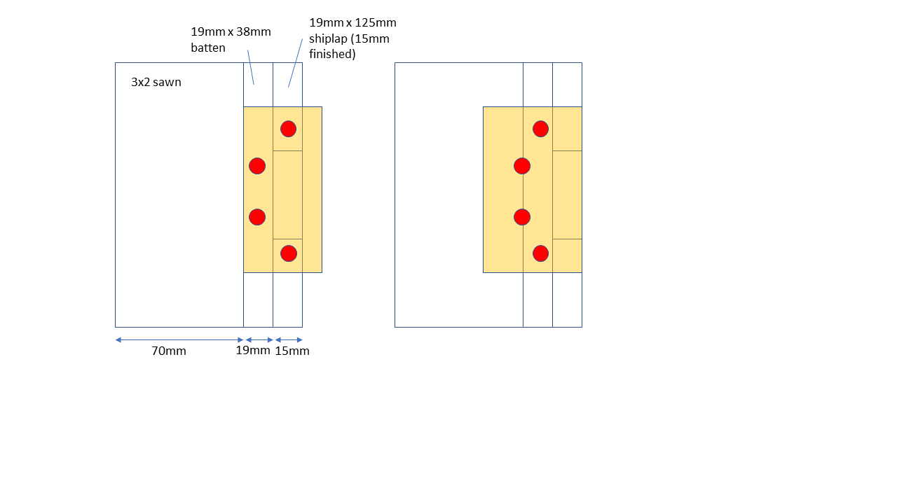

I've bought these in both a standard size, and a parliament hinge style. My issue is that regardless of where I place these, because I have gone for a stud>membrane>batten>shiplap construction, the screw holes do not line up to the studs, which is what I was originally hoping for.
The two options I seem to therefore have are:
Standard size hinges: 1 set of holes line up into batten, the second set into the edge of the shiplap (eek!?)
Parliament hinges: 1 set of holes line up into batten, the second set exactly between the stud and the batten.
Now the batten was screwed into the stud at approximately 10-12" intervals, so should be held fairly solidly, but I'm wondering whether a 5mm screw will bite sufficiently between the batten & stud, or whether an insert nut, glued into place between the two and an M6 bolt then threaded in might be more secure?
If I'm also missing something obvious and there's an easier way to be thinking about this, then please let me know!!

Butt hinges are not really conventional on such external doors, this combined with a tenuous grip by the screw into end grain on T&G is not really a good fixing at all.
One thing I would suggest you consider is the positioning of the "T" hinges, they should both ideally be screwed through the Shiplap into the framing.

Is it an anti gravity shed?
I only ask because you have some black thing just floating
Chaps, just wanted to say thanks very much for all of your replies.
On the basis of your advice, I've scrapped the butt hinge idea (as much as I love the look of it) and gone for some hook and band hinges.
FWIW, the tee-hinges that I'd been looking at were the "heavy duty" Smith & Locke version (you can probably guess from where), but one hinge was bent significantly out of place, which wasn't reassuring out of the packet.
With regards to the hook and band hinges, part of me feels a little dubious about putting all of the weight on the bottom hinge (on the basis that I'd look to flip over the hook on the top hinge). Is this concern warranted? (I'm more than happy to buy a third hinge for the middle of the door if this would help but aesthetically, two might look better...
And Notch, to answer your question that did make me smile, it's a roofbox that will be stored above some other large bulky items, so I didn't want any framing in the way. I've put some 20mm galvanised conduit pipe into some extra studs, hence the "floating"! :)
