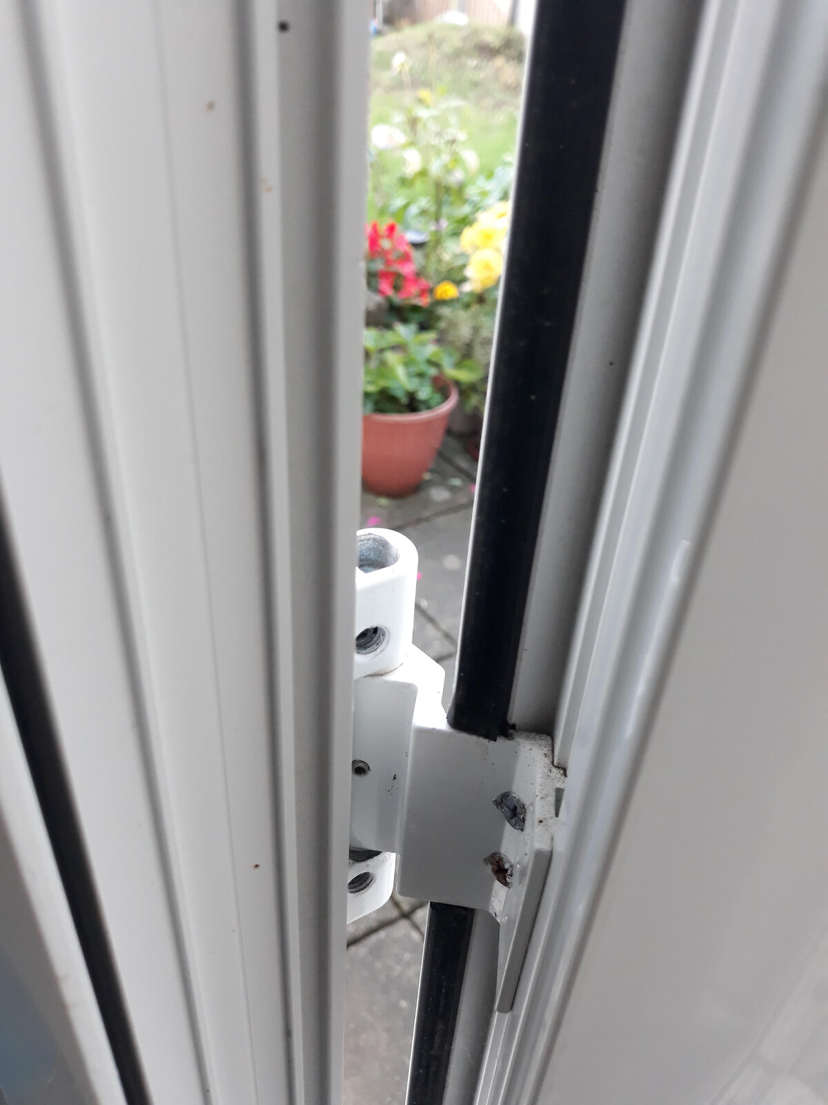

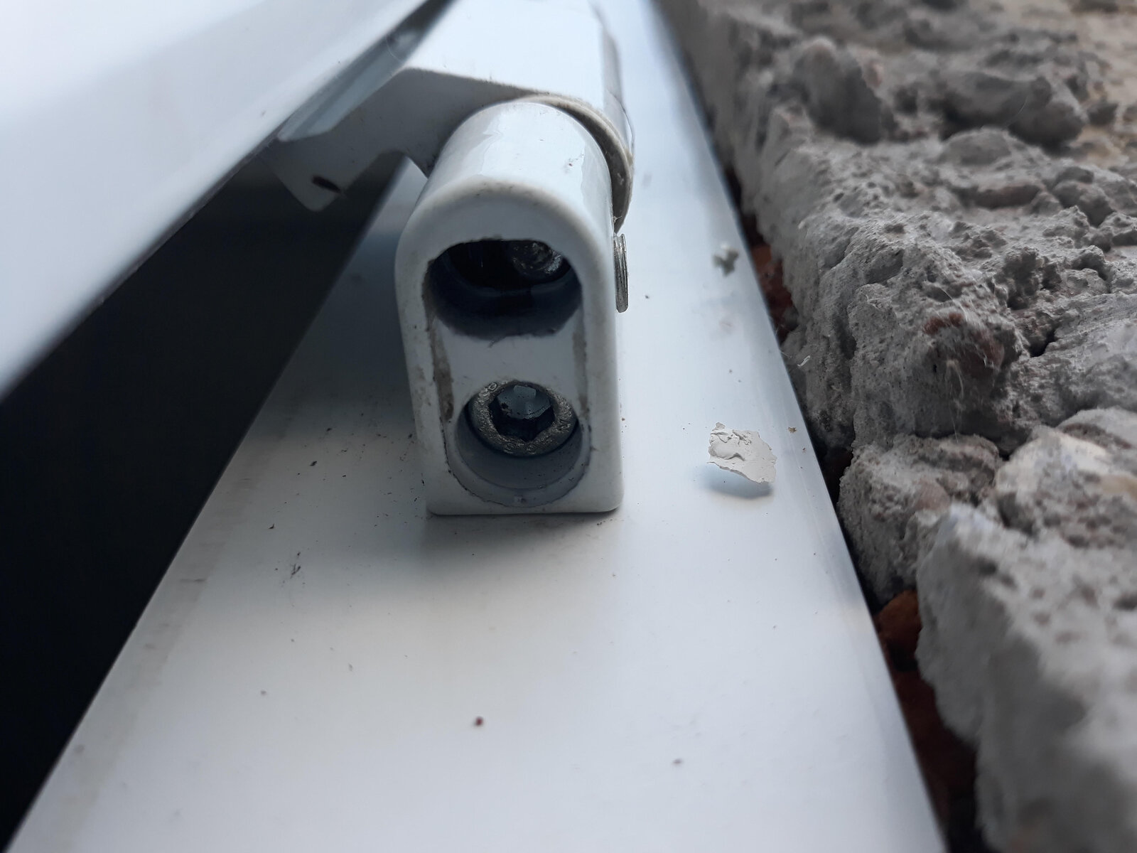

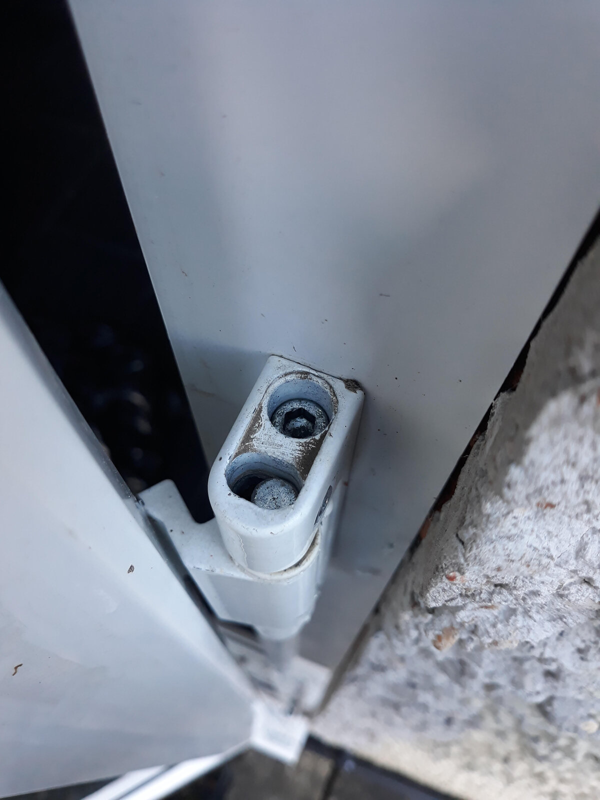

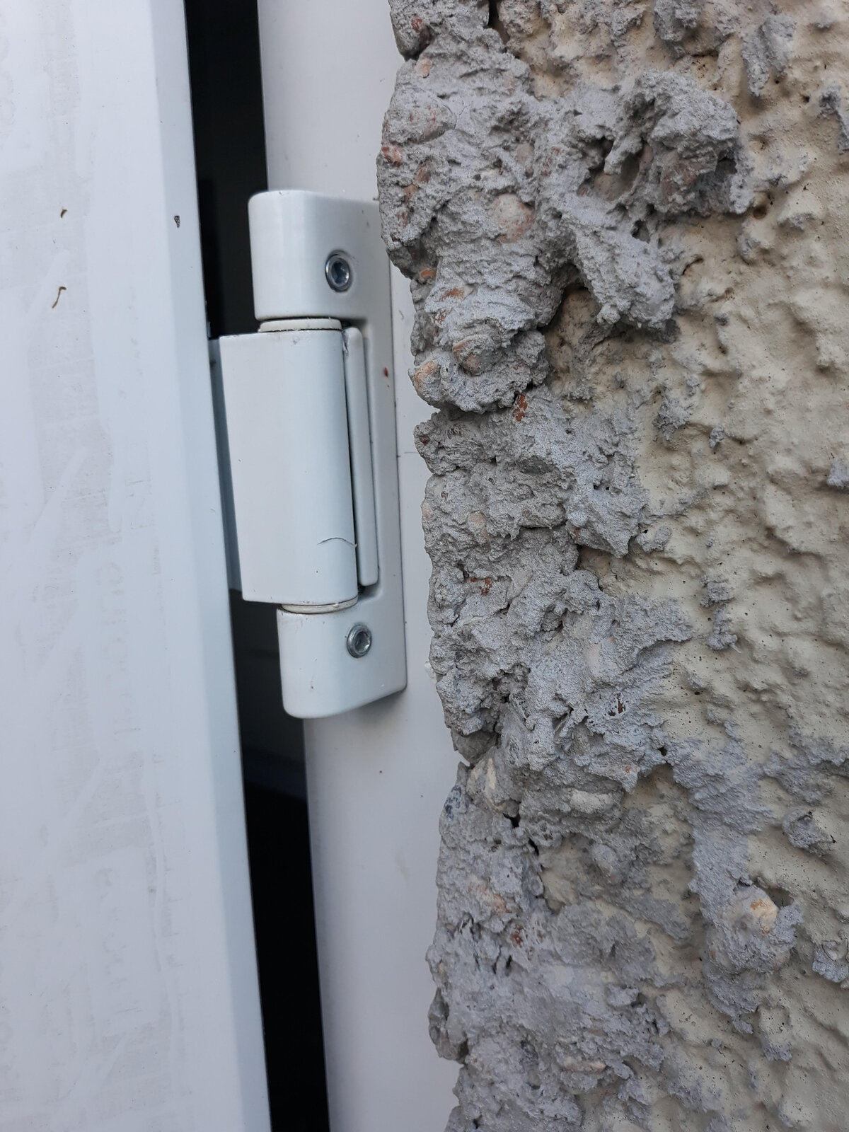

Pics attached. I adjusted the bottom ones and it was clipping against the bottom of the door.
Also, the draught gap seems to be about 4mm and these hinges can only do ~2mm but it seems like they don't want to budge much vertically either way unless it's downward.

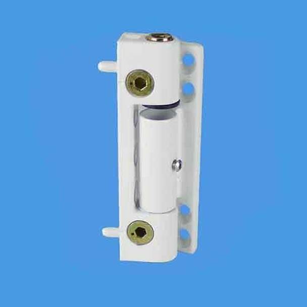

I may be wrong, but It looks as if it is a Mila iDeal rebated butt hinge.
https://upvcspares4repairs.co.uk/mila-ideal-euro-rebate-door-hinge-white-22mm-leg-13mm-axis.html

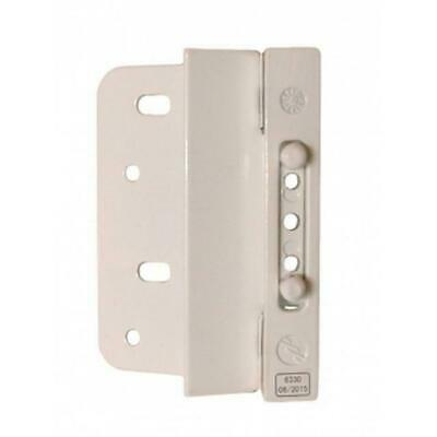

The height adjustment is achieved by a moving backplate.
I am trying to look for some fitting instructions to see if there is anything we are missing!

However, the back plate holds the two pins in this image:
Adjusting the height on many hinges will move the leaf up and down, hence using the bottom adjustment.
With the Mila, it's the pins on the backplate that are moved, it is likely that the top cover houses the height adjustment!

Thanks mate. I think I'm going to upgrade the hinges, I need more adjustment because of the gaps but it looks like these hinges are knackered, the height adjustment isn't really working alas.
