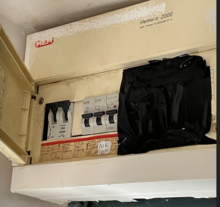

Hi all,
We're looking to buy a house at the moment. The property is generally sound but even to my partially knoweldgable eye there are some serious defects with the electrics, including:
- Undersized conductors for circuits
- Inappropriate MCB specification and circuits for applicances
- Lack of labelling, incorrect labelling, no evidence of any testing
- Standard T&E direct buried in the earth to feed the outbuilding
- One MCB on the main CU feeding the whole CU for the extension, in turn with one MCB feeding the CU for the outbuilding. All with 100A main breakers and all coming from a single 6mm conductor from the main CU.
We've requested evidence of electrical works/certificates but the vendor has come back to say none exist, which is possible as the work was done prior to 1998. However the CU in the extension is an absolute state, I can't believe this was ever done by a 'professional' (yes, the black tape covers the fact there are no blanking plates and the bus-bar is directly under this).
This is only the second house I've ever bought and my first non-new-build. Is it reasonable to request the seller gets an EICR and corrects any major defects? Or is this part and parcel of buying an older building and on my shoulders?

What is in the extensions and outbuilding? if the run is not excessively long then 6mm² is likely good for at least 32A and maybe 40A. If it's just sockets and lights that is probably enough.
The main CU has a 40A MCB supplying the extension CU via 6mm T+E which has:
1x 40A for electric shower
1x 32A for living accomodation sockets
1x 16A for garage sockets
4x 6A for garage lights, living accom lights, exterior lights and smoke detectors.
Then another 40A MCB supplying the outhouse CU via 6mm T+E which has:
16A for sockets
16A for electric heaters
6A for lights
I guess ultimately it's all protected by the 40A MCB in the main CU so maybe I'm being over sensitive. It would probably be ok if it wasn't for the shower, and its pretty obvious the shower was added at a later date than the original installation becuase the wiring is all over the place.
As you say it's all protected by the 40A MCB in the house, but overload protection devices are not supposed to be used as load limiting devices. You shouldn't plan to overload a circuit.
I agree without the shower it would be fine load wise, with the shower you are seriously pushing it since the shower will likely take most of the 40A on it's own.

That board looks like someone's used it before and it's put in to save someone some money. I had loads of MEM MCB to RCBO conversion kits a while back.

IMO the biggest question is does the installation have "good bones" with some bodges on top that can be remediated, or does the bodgery go so deep that the only real option is a rewire.
The taped up CU worries me not because the CU itself is difficult to replace, but because it may reflect the attitude of whoever did the wiring work that is fed from said CU.
