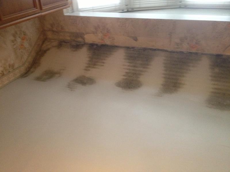

buying a house with damp?
Looks like a thermal bridge/condensation problem. You'll need to insulate behind the plasterboard
Thanks for the reply. if this is not serious problem then I would like to offer. by looking at pictures you probably think its not serious problem? what could go wrong here? timber issues etc?
Are the photo's upside down? Looks to me like you have a wall with the sloping part of the roof coming down. Could be a leaking roof and nothing to do with thermal bridging. ;)
apologies, yes, they're upside down. so nothing serious you suspect?
Thanks,

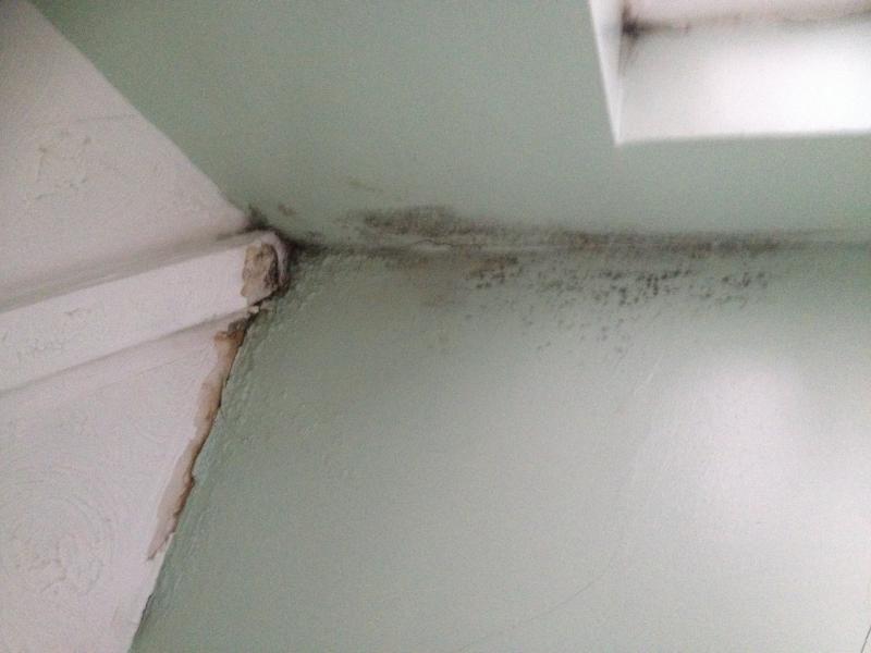

First pic? Is that the inside of the ridge? If so, then could just be the pointing of the ridge tiles.
Second pic - Looks to be an issue with the flashing above the bay window.

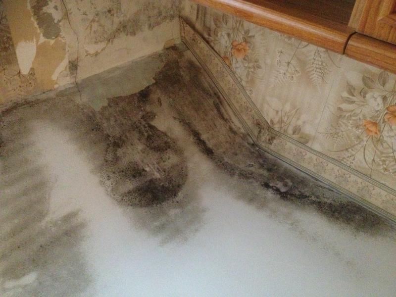

Third pic - Not sure, maybe an issue with the guttering, or the soffit area?
All of these could be reasonably easy fixes. Main problem is how long has it been going on, and is there damage to the roof and bay window structure?
Jay
There is no coloured staining to suggest that there is water penetration. It seems to be purely condensation related with the associated black mould
In those raked ceilings, it might be difficult to get access to insert insulation and to maintain ventilation to the loft
Either way, its not a major cost or major job

There is a big difference to penetrating damp and condensation damp, and a big difference in the cost of dealing with it.
In this case, condensation may well be caused by the occupier's lifestyle (ie not opening windows or using heating) and so i could be an easy fix.
Obviously, we cant advise you from pictures, so whether a specific survey is necessary or not you will have to decide
However, that mould would be a useful bargaining point for a price reduction, and would not be a reason not to buy a property
