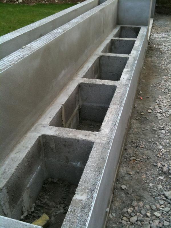

I have built a retaining wall in my backyard with an integral bench seat in it.
I orignally planned to use slate as the bench material (to match the patio) but the boss now wants a hardwood bench.
Having expressed a preference for teak, I'm having trouble finding anyone that will sell me teak timber, as opposed to ready-made teak garden furniture.
Any pointers much appreciated.

Here is my wall with integral bench:
I gave up with the teak idea bearing in mind I need 15ft lengths. I felt like a drug addict trying to get hold of it in such quantities...lots of "oooo-ing" and "ahhhh-ing" and "I'll phone my supplier and get back to you..."
I've gone for 4 planks of Iroko in 3" x 6" x 15'
Next question: How do I attach it to the blocks?
I was thinking of mounting some smaller battens on the supporting blocks and then nailing/screwing the Iroko into that.
Bearing in mind the design, I think I'm stuck with that although I'd prefer not to have to come through the top of the wood, thereby spoiling the uppermost face of the wood.
Anyone with any better ideas?

Two thoughts.
1 prefabricate the benches upside down, screwing through the battens (from what would be underneath) into the main slats (so the screws don't protrude), and then turn them over and fix through the battens between the main slats. Use expanding polyurethane glue too, it survives well outdoors.
Or
Make a feature out of the fixings. Counterbore the fixing screws and plug the bores with ebony dowel - OK so ebony is a bit of a longshot but you could use any interesting colour, or even the same wood.
Make short dowel by mounting a thick washer (with the right diameter hole) onto a block of wood with a bigger hole in it - then cut short pegs of wood along the grain just larger than the washers hole - and hammer them through the washer. Tidy up the ends.

If the seat was removable, you would have loads of storage space underneath, by the looks of your bench build?
Maybe for pots, smaller gardening stuff, partially dismembered SWMBO..... :p
