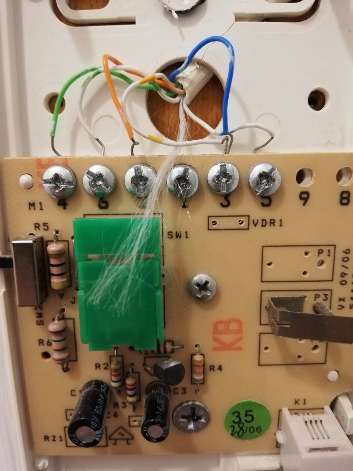

Hi all
I was wondering if anyone can help, I've been battling with my Videx entryphome system for months now and have some of it working, I'm a joiner by trade and not very close up on electrics as you can probably tell. It was not a like for like handset replacement so I improvised but the buzzer is not working despite trying a few different combinations and wondering if anyone can help?

It was a Videx but an old model with a completely different layout. I made a conscientious guess with the wiring, it's an old tenement I am in and the speaker seems to work, the lock release the reciever seem to work but not sure if that is just luck?

The manual for the replacement does state it accepts electronicronic calls, I just thought I'd ask the question but may need to get an electrician in to wire it it think
The handset does ....but the system ....maybe not ..as some use 12ac for buzzer , some use dc for the call, you may end up having to fit the correct handset for the existing system
Hi 3george, it is a big help thanks for that, I am still struggling though as I'd imagine an electrician would look at that and know exactly where each wire goes but I would need to find out what each number meant off the main unit (or what colour that wire would be) so I'd know where it goes in the handset, I'll keep trying though
I don’t think it has sunk in...it’s not going TO WORK if your system only supports buzzer ( AC ) call .....

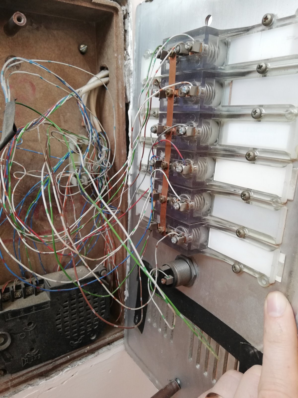

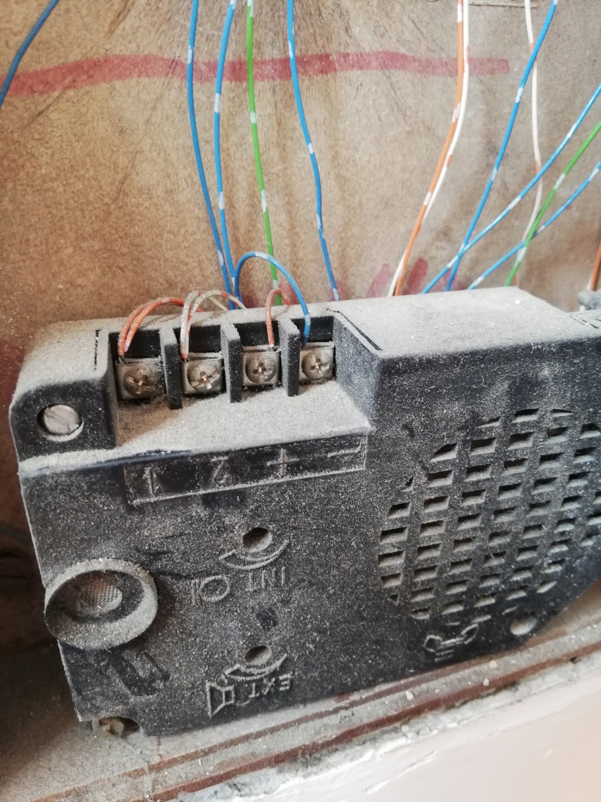

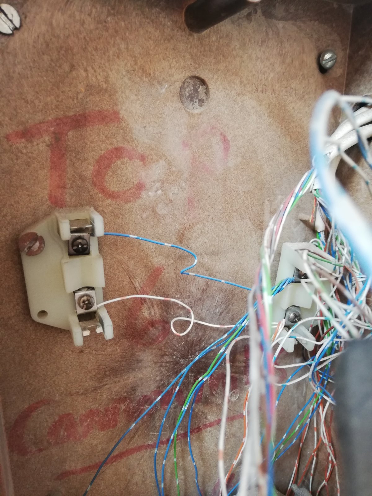

Thanks 3george, yeah that link is the one I have purchased and just upgraded the older model. I have taken a couple of pictures of the entry system itself, not sure if it will help but thought I would give it one more go as seems a shame to have to get an old handset just because the buzzer is the only thing not working
