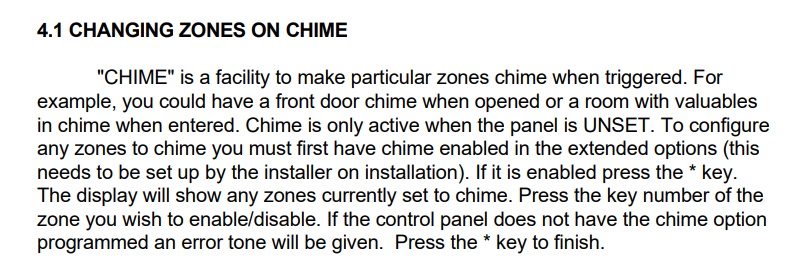

Is it a chirp? Like a smoke alarm type bleep?
The 700L doesn't really beep unless it's the chime feature that's been switched on perhaps?
It sounds like a beep to me from an internal speaker. It's not the smoke alarm as I've checked those first before realising it's the security system.
I'm not aware of chime feature as I never really turn it on before this. Can you explain a bit?
In short, press the star key, should be no lights illuminated.
Thanks. I'll try again when I get back home later today and report back.
