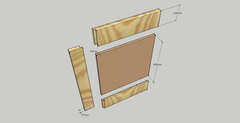

Quick q ... bit confused by construction technique for a cabinet door. Want to use 27mm thick Pine rails & stiles ... with 18mm MDF panel inset ... but I don't want to go to the hassle of making a groove etc., just want it to sit in a rebate.
Is that ok? Or will gluing/nailing the panel to the pine outside 'frame' defeat the whole purpose of a panel door?
This is for a living room type area - not high moisture etc.
Picture attached!

Uh .. no bead involved ...
This is a view of the door from the back. The 18mm MDF panel just sits flush with the back of the stiles/rails in a 15mm rebate.
Was going to pocket hole the 'frame' together, and simply panel pin & glue the MDF to the rebates ...
well it may well work out ok for you,but do bear in mind that as you have 2 differing materials they will expand and contract at different rates so it may well end up cracking.
if you can make the rebate a tad deeper then you could fix a basic beading thus allowing the panel to move independently to the frame.

if your doors are less than 600mm then i would say risk will be minimum rebated and glued but what may happen is the doors may bend as gregs says expansion and contraction

It won't work. Traditional frame and panel doors are made with the panel either trapped inside grooves in the door frame or rebated and held by beading (bolection moulds, etc). The panel is never glued or pinned - ALWAYS loose (except for 100% MDF doors). The reason is simple - timber expands and contracts at a different rate across the grain and with the grain - so if you fix the panel it will eventually split, or the frame will. I'd agree with the comment that 18mm is also too heavy - if you must use MDF for a panel, go with 6 to 12mm.
If you want a more robust edge with MDF, use MR-MDF (moisture resistant - green or green core). This is denser and holds crisper edge detail
Also, if you are going to use concealed (kitchen) hinges be aware than they are generally limited to doors between 16 and 22mm thickness - thicker than that and you start having to alter the mounting plates, offstand,etc

Yes - all in all it will probably be better to go with 21mm finished softwood frame, and then have a 12mm MDF panel set back 9mm. Lighter, and easier to get the concealed hinges to work with less of a reveal etc.

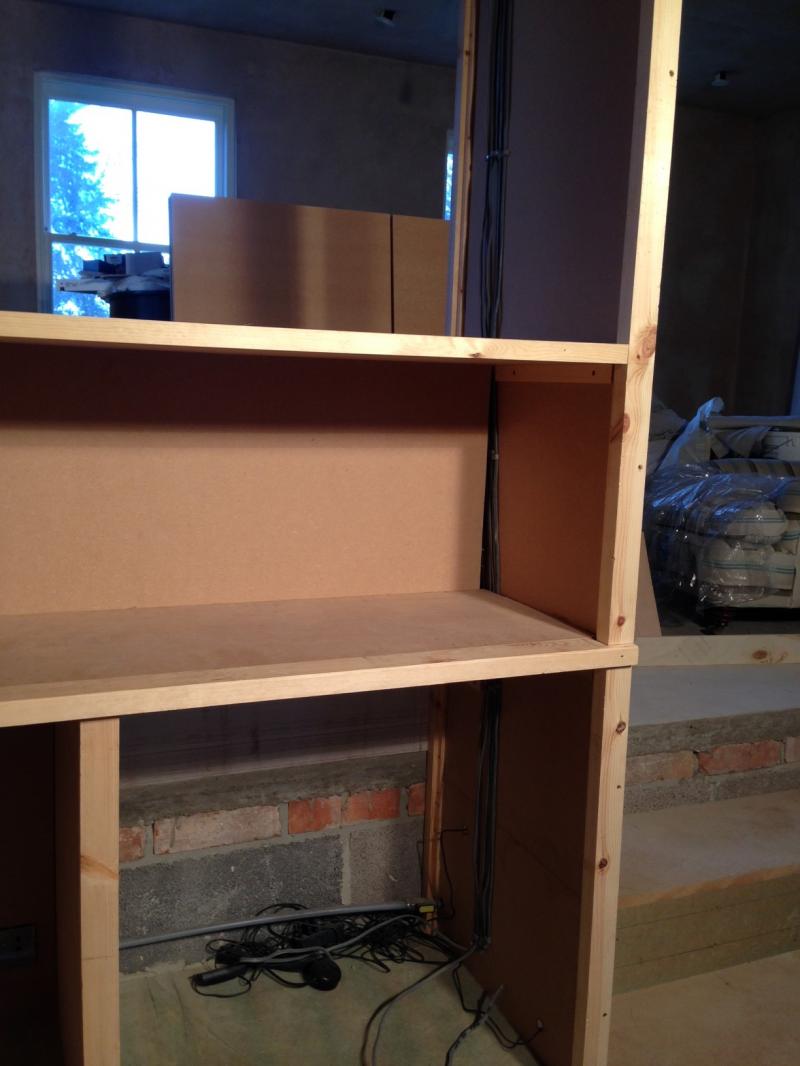

Re: mixing MDF with softwood, now I'm getting a little worried now about the make up of the rest of the cabinets ... which were started off for me by a joiner.
Because I wanted nice chunky partitions & walls, he used 25mm MDF as an outside skin, and 9mm MDF as an inside one, with some rebated 50mmx50mm PAR softwood serving as a separator front & back (see picture).
I was pretty sure it was going to be fine, obviously it is going to be painted anyway ... but now getting concerned about this movement issue! Also, I was keen to face all the 18mm MDF shelves with 5mm thick hardwood strips ... which I remember doing in a homemade kitchen 20 years back and which never seemed to be a problem ... any thoughts on either of these matters?
those are normal practice
what you need to remember all stresses are within a box so no cupping and bowing any movement is contained
where as a door all stresses and cracks are on full display :D
