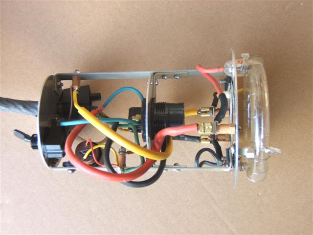

This is pretty much the flash head. Image is a bit messy as it was taken as an illustration of the cable rather than the wiring layout. The model lamp socket is the black thing in the middle (Blue wire). The flash tube is not in this image, but the yellow (sheathed), red and black wires at the top go to the tube, which is mounted on a plate that screws onto the L shaped arm at the lower right (and similarly at the top.)
All other large capacitors are in the unit.
There should be 3 wires to the flash tube - the HT supply, and a trigger wire.
From the sound of things, the HT supply for the flash tube goes up the multicore cable. To know whether a specific cable is suitable, you'd need to know the voltage used on the flash tube. However, I'd have thought it unlikely that the voltages would be within the specification of the cable you have been quoted. See https://en.wikipedia.org/wiki/Flashtube#External_triggering

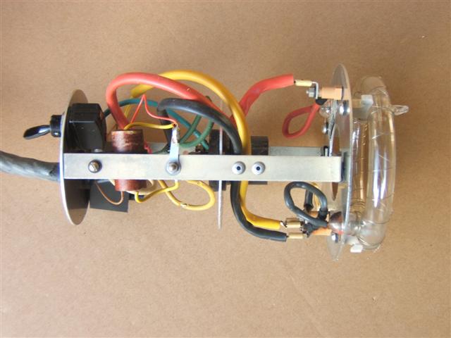

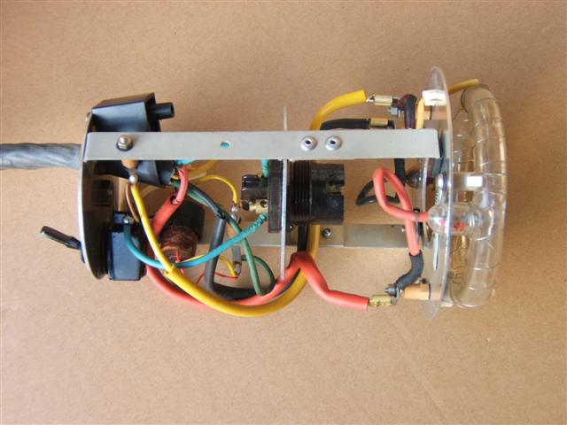

Had a look inside the head again today and this is how it is laid out:
Black and Red go to the flash tube.
Blue is to the modelling light, with another length of blue to the switch.
White goes to the modelling light switch (so blue and white are only for the modelling light)
Green is earth.
Yellow is to one side of what is presumable the HT Trigger. On the same side, there is a brown coming out of the HT.T that wraps around the flash tube.
The other side of the HT.T has a red and yellow that go to earth.
It is not too difficult to rewire, just need to know that the 1mm2 cable rated to 750V is correct? The insulation is slightly less than the existing (which is why the possible replacement is smaller diameter) but maybe current insulation is better than that from 30 years ago?
Any thought greatly appreciated.

The important question which hasn't been answered yet is:
What is the operating voltage of the flash tube and capacitor?
If it is signifacantly below 750V then the cable should be suitable.
What is the 'voltage rating' of the capacitor in the main unit? that will give us a clue.

Yes but the flash tube wires have been given an extra layer of insulation within the head unit and I wonder why.
That I don't know, but I can confirm that only the cores of the perished cable is rubber / silicone insulated. All other wires in the unit and head are PVC insulated and appear to be in good condition. Perhaps the extra insulation is just a belt and braces approach?
Cannot see any notification on the flash tube itself and nothing inside the heads. On top of the power pack, 200 / 250 V 50 Hz; 800 w/s.
Inside there are 16 main electrolytic capacitors and a bunch of smaller ones that I cannot get visual access without a major dismantling. For what it's worth, 15 are the originals, and one is newer but was replaced some time before I bought the unit.
From what I can see using mirrors and an endoscope, they are all made by DALY / 500uF / 450v DC / and have PF 350 450 written on them. Other markings FTL 61 / 12 WKG and the newer one has L00 B36S (or it may be LOO B36S?)
My unit is number 1586. These where never major professional units, designed for rugged everyday professional, location use. It is an amateur / studio / occasional use flash unit, but obviously the internal power is still sufficient to give one a serious blast.
To be honest, I would have thought it unlikely that Courtenay had special cable made for them so I would assume the cable was something readily available; but what do I know?

You're right, they are unlikely to have cable made but they are so many cables out there to chose from the chances are anything within reason can be sourced.
That said I'l now make the assumption that with the caps rated at 450V the maximum operating voltage is likely to be well below this and a 750V cable should be more than adequate.
This is my remote assessment which I can of course not guarantee without hands-on inspection/testing.
