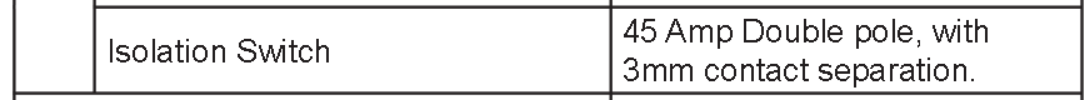

In another thread you quote several shower manufacturer's instructions; one of which states:
It doesn't say 'minimum' or 'at least' 45A so would a 50A switch be following the instructions?
