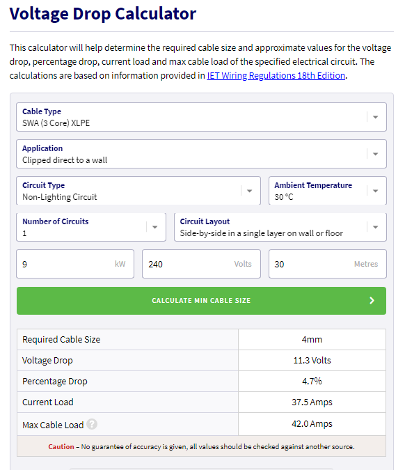

Cable sizing a shower
10 Feb 2007
1,393
41
Cumbria
9kw shower
30m cable length
SWA
Clipped direct outdoors uncovered
What would the CSA be on the cable?
Cheers in advance
9kW @ 240V = 37.5A
so 40A MCB.
so 4mm. SWA clipped or buried in masonry.
You might care to use 6mm² to cover a larger shower.

Well do the sums rather than relying on instinct. Cable type and installation method are more important than you might think
First time I have ever heard someone suggest 6mm for a 9kw shower.
You need to get out more.
I suggested 4mm².
9kW @ 240V is 37.5A
4mm² SWA has a Method C CCC of 42A, and
6mm² 53A
10mm² 73A
