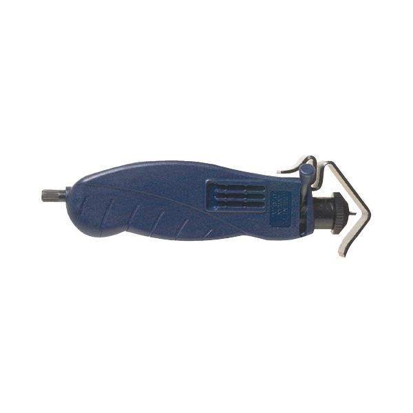

Morning everyone,
Anyone used one of these ? does it avoid problems with nicking the insulation when trying to get the sheath off using a knife ?
Thanks, David
Only good for round cables, we used to use them for BT cw1108 external heavy sheaf cables.
No point in having them in a sparks tool box, a stanley knife is still the best sheaf remover for TE cable. I haven't knicked a core sheaf in years.
Thanks Chri5,
I won't bother buying them. Do you know of any tool tat is good for stripping the sheath of t&e ?
Thanks David

I could do with a stripper for my wheelie bin of scrap cables (various sizes) because I just cant bring myself to see it go for such a **** poor amount with the insulation still on.
Any ideas? I've found a steady hand and a stanley knife is the best way, may experiment with hook blades.
2) If Romex sizes are close enough to T/E for it to work.
It appears to be designed to strip the sheath on anything from 2+Gnd #14 up to 2+Gnd #6 NM cable, so I would think it would probably be effective enough for at least 1.5 to 6.0 sq. mm. T&E:
http://www.acetoolonline.com/Klein-74018-Cable-Ripper-for-14-6-AWG-p/kle-74018.htm
I wonder whether whether it might not cut right through the middle of the sheath though, as British T&E has the PVC take a mold right through to the bare earth whereas American NM cable has an outer sheath which is consistent in its thickness around the whole cable.

Nothing wrong with it IMO as long as you ring round the point where you want to strip the insulation back to using a stanley knife in order to give a clean edge. Apparently many college lecturers say it will damage the cable, but this just isn't true, and I have yet to meet a spark who has had any problems on account of stripping T+E this way.
