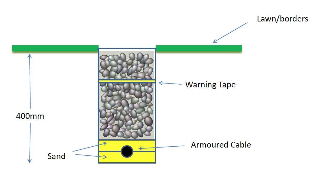

Hi, I want to run a cable under a lawn to a tree for fairy lights. The run is only about 10 feet from a wall.
I want to use an RCD plug into a normal socket so its classed as a portable appliance rather than hard wired in.
So I am assuming I need one of those outdoor boxes fixed to the wall (like they have at B&Q) that an external cable can be run to then inside the box connected to armoured cable (or more outdoor rated cable), then run under the grass in conduit (if I run in conduit how do I stop water ingress).
If anyone could advise how much of this is correct / incorrect and the regulations that need adhering to I would be most gratefull.
Thankyou for any constructive answers or advise but please dont shoot me down I'm only asking a question.

Use SWA under the lawn, not conduit, about 1 metre deep then there will be no water ingress.

A lawn is one of the worst places to bury electricity. Some unsuspecting person always comes along in the autumn and aerates the lawn. I've seen it done, it makes a big bang. If you're lucky it doesnt take Mr Lawnman with it.
Here's what you do
Here's what you do
