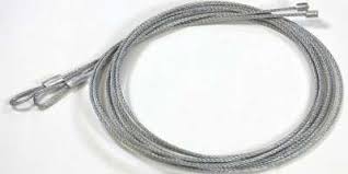

Also, does anyone know what a steel (maybe 3mm in diameter) cable would be for. It seems to be winding it's way amongst the electric cabling. It is frustrating as it is preventing some of the cabling being attached to the joists by retaining clips to keep it out of the way while I am down there. Is it possibly some kind of tracer wire for the gas mains pipe? It seems to disappear under ground....

cable could be a legacy earth cable?

Hmm, legacy earth is certainly something to consider.
It is very similar to this in style:
Although I have not traced either end yet. One end certainly goes into the ground, in around the area the mains water comes in, and then snakes through the electric cabling to the other end of the house (to where I do not know yet).

I found that sort of thing in our house, bonding to all the pipework at various points.

Solved: It seems to be a legacy earth.
The cable is indeed un-sheathed copper. What confused me, probably because it is so oxidised and/or dirty, is that there were lots of silver shiny specks along it's run (as if it was steel underneath). No attraction with a magnet and after a good scrape the copper colour was visible. Tracing the other end led to the location underneath the consumer unit. But it is not connected to anything.
There is also another legacy earth cable in a solid green sheathing, again disconnected under the void at the consumer unit, but leading and connected to the mains cold.
This has also been superseded by what I assume is the current, much thicker copper earth sheathed in yellow and green, tracing the same route but this goes up through the floor boards and is bonded where it can be (I assume) more easily inspected.
I will remove the old legacy cable as it just gets in the way at the moment.
