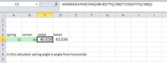

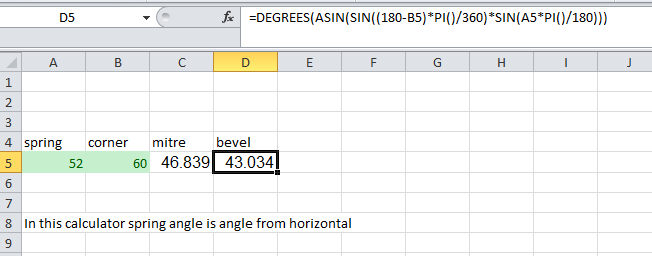

I am making an Octagon pitched roof from wood.
At the base of the pitched roof the distance between the opposing pieces will
be 290mm (external)
The height (vertical) will be 500 mm
What angle do I need to bevel the sides of the bits so as they fit snugly together, and how would you calculate it.
Just to be clear what angle I'm after
be 290mm (external)
this is what I got 18.5 degrees, but really not sure how to work it out
