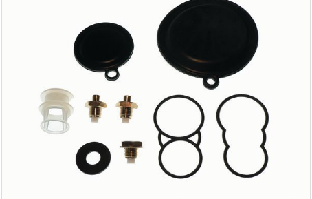

Each year I have had the large diaphragm 6872 replaced. I have learned that Vokera do a kit T0019 ( please see below ) which contains the large diphragm 6872, however the engineers who have serviced my boiler over the years have never used the T0019 kit. I was wondering if you might be able to explain why ? I am just curious what the other smaller diaphragm and other parts do as they have never been replaced ?
Does this sound as if the diverter valve is passing ? Is this normal / to be expected ?
