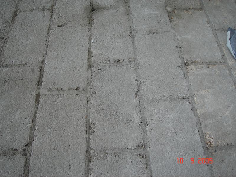

Hi Roughcaster
The PVA that I sourced for the roughcaster is Exterior Grade - Waterproof PVA from Unibond.
I take it that once this dries it can not come back to life when wetted ?
I have uploaded a picture of one section of the wall which was stripped back. You can see the blocks are quite clean.
Would you consider this smooth and thus in need of a stipple coat ?
Cheers
For what it's worth, I agree with the RC. Don't use the ordinary PVA, use the stuff recommended.
(I usually use SBR myself)
This might sound a bit contradictory,, but Waterproof PVA is only waterproof when mixed with cement,, it says that on the tin,,, although it's far superior the normal internal grade. As Micilin said,, and what i said earlier on,,, SBR is the ultimate bonding agent in your situation. The blocks themselves do look smooth, with very little key, even on the joints. I'd go for a slurry coat , but it's up to you.
Roughcaster.
