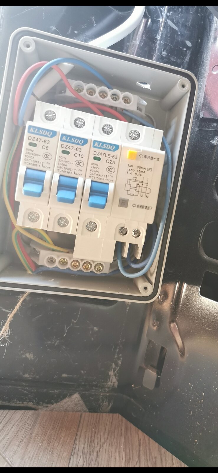

Hi all,
Hoping someone is able to help before I test this. Ordered 240 hook up for campervan and came with small consumer unit that had absolutely no instructions. I've tried to wire it up how I think it's me at to go but not 100% sure it's correct so thought I would check with the experts. Attached image shows 240 insert coming into unit and cable at top is a double socket. I'm not sure what the small box is below the trip switch on the right? Any help would be greatly appreciated, I'm a joiner to trade so not the most technical when it comes to electrics.
That doesn't look right - the box on the right is the RCD, it should have a supply L and N it looks like you have L to N supply/load.
Without wishing to be rude, the reason CUs are supplied without wiring instructions is said to be so that people not competent to do the work will not be encouraged to try.
Do not connect yours to a mains supply.
The C25 MCB is linked to the 30 mA type AC module to make the combination into a RCBO, but there must be some internal connection and from the diagram I can't work out how it should be wired. There seems to be one two many terminals, and clearly old stock as type AC no longer used.
Since DIN rail mounted I would throw away the units and fit two proper RCBO's instead one 10 amp and one 6 amp and get type A instead.
Does seem odd to have a diagram showing 4 terminals and the device has 2 + 3 = 5 terminals, some thing wrong there.

I would not use that item.
If you value the safety of people and property in your camper van then invest in items from a reputable manufacturer sold by a reputable UK company, Even better employ an electrician to supply and install the equipment.
That may seem harsh but experience is that dubious items can fail to operate when there is a fault that requires them to operate.

I suspect the bottom screw on the MCB part of the combo is only used to feed power into the MCB from the RCD module but you‘d have to do a quick continuity test to verify that. That’s just a theoretical consideration though, as I whole-heartedly agree with the suggestions of replacing the guts of the CU entirely.
