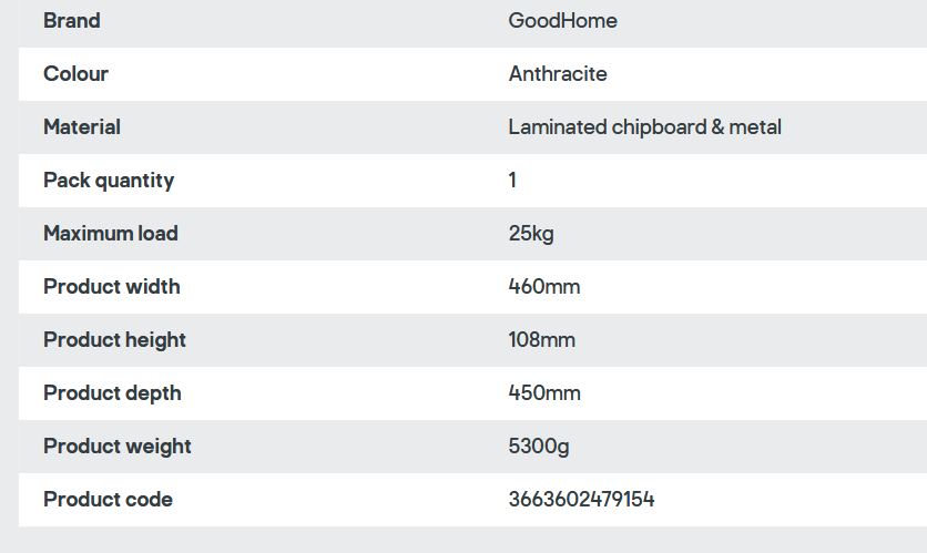

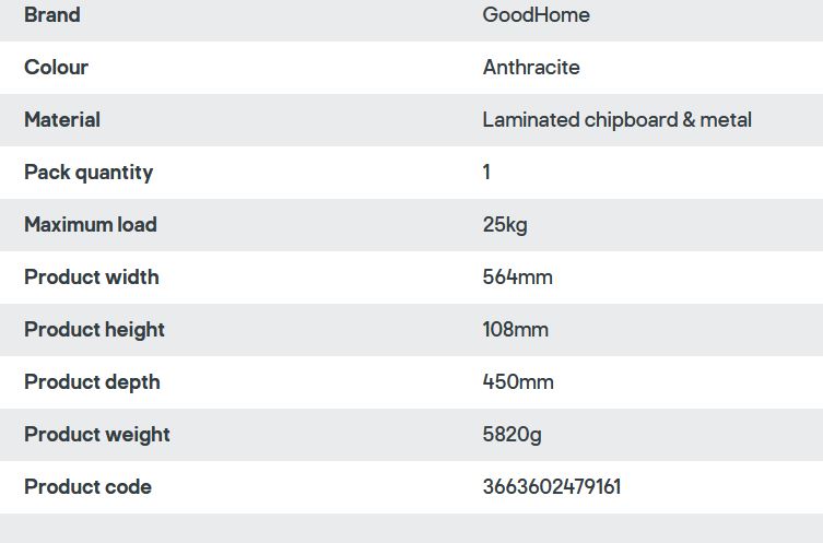

Actually I have just spotted something, looking at the info on B&Q i was going by the 600mm box that states the internal as 564mm so I thought that the 500mm box will follow the same - i.e 464mm but it is actually 460mm
Here is the 600mm box
And here is the 400mm box
Now to add to the confusion I have just come back from B&Q and they had on display a 500wide unit and draw so I measured the internal and it is 464mm so it would appear that I will struggle to get the drawer box in my 500mm (460 internal ) cabinet.
