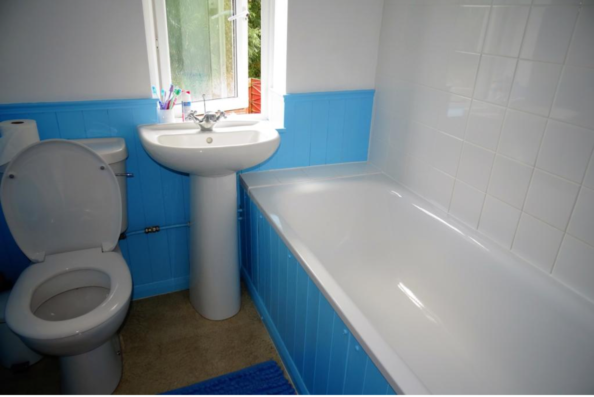

First time poster here. Bathroom location is 1st Floor. Can a chased in brick concealed cistern be installed where the current toilet is or even swap with the sink and go under the window instead? This wall is a single solid wall (non cavity) and on the other side of the window is an extension, so there is a possibility to support/build up wall outside if required for things like insulation. This wall is load bearing as it is the back of the house. Would I need a lintel?

Can't go where the basin is just now as there's a bath in the way ;) .

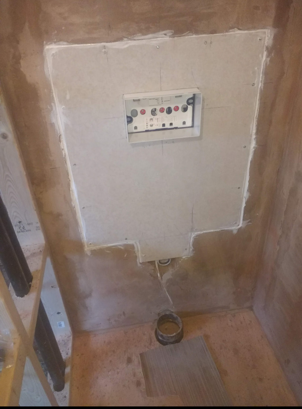

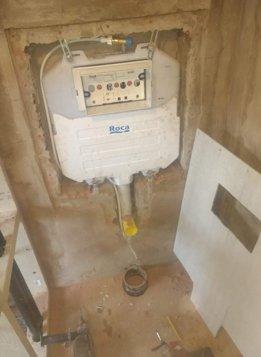

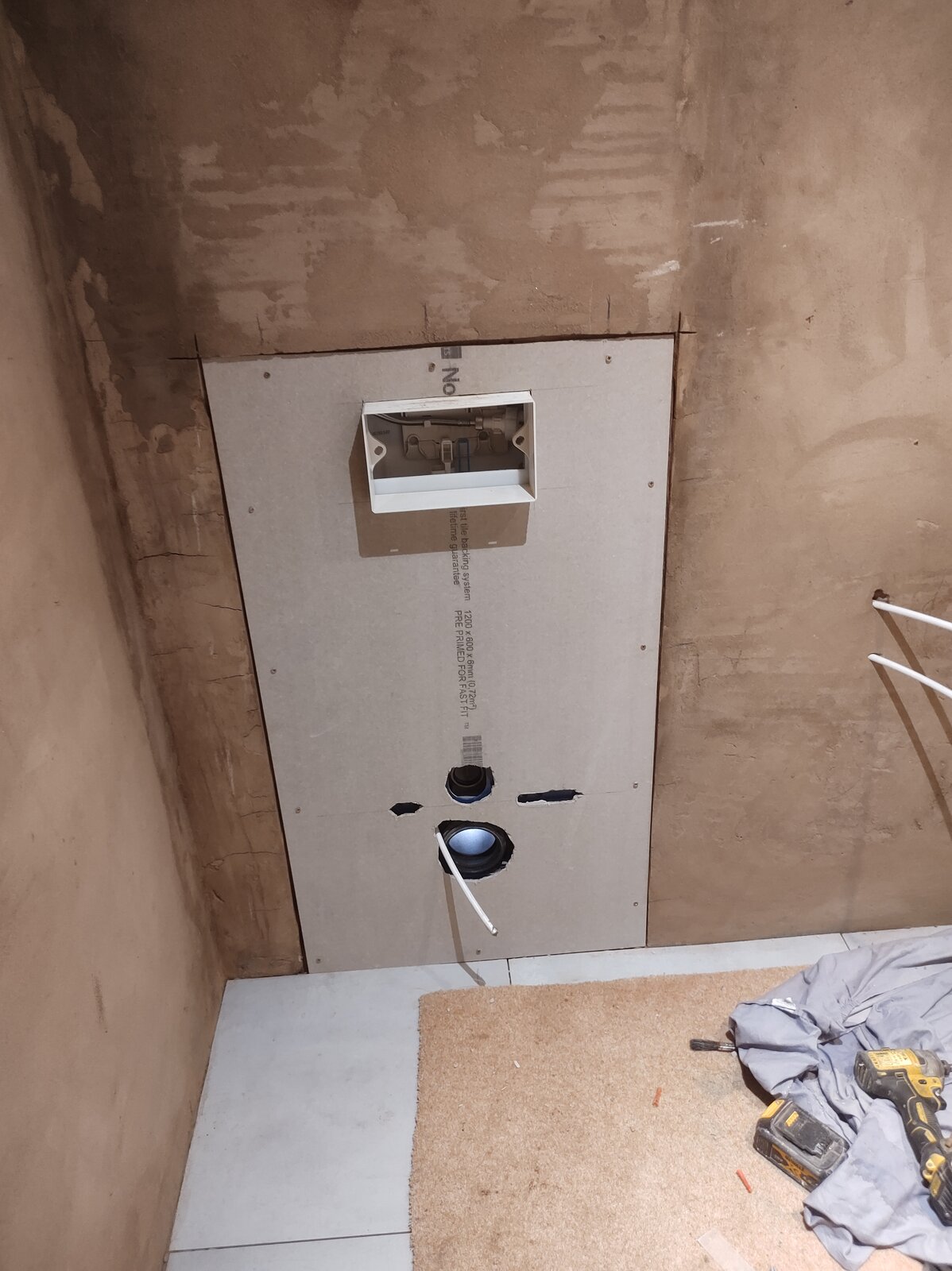

This is a floor standing WC so just the cistern in the wall (9" solid wall):

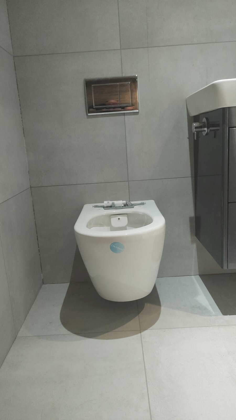

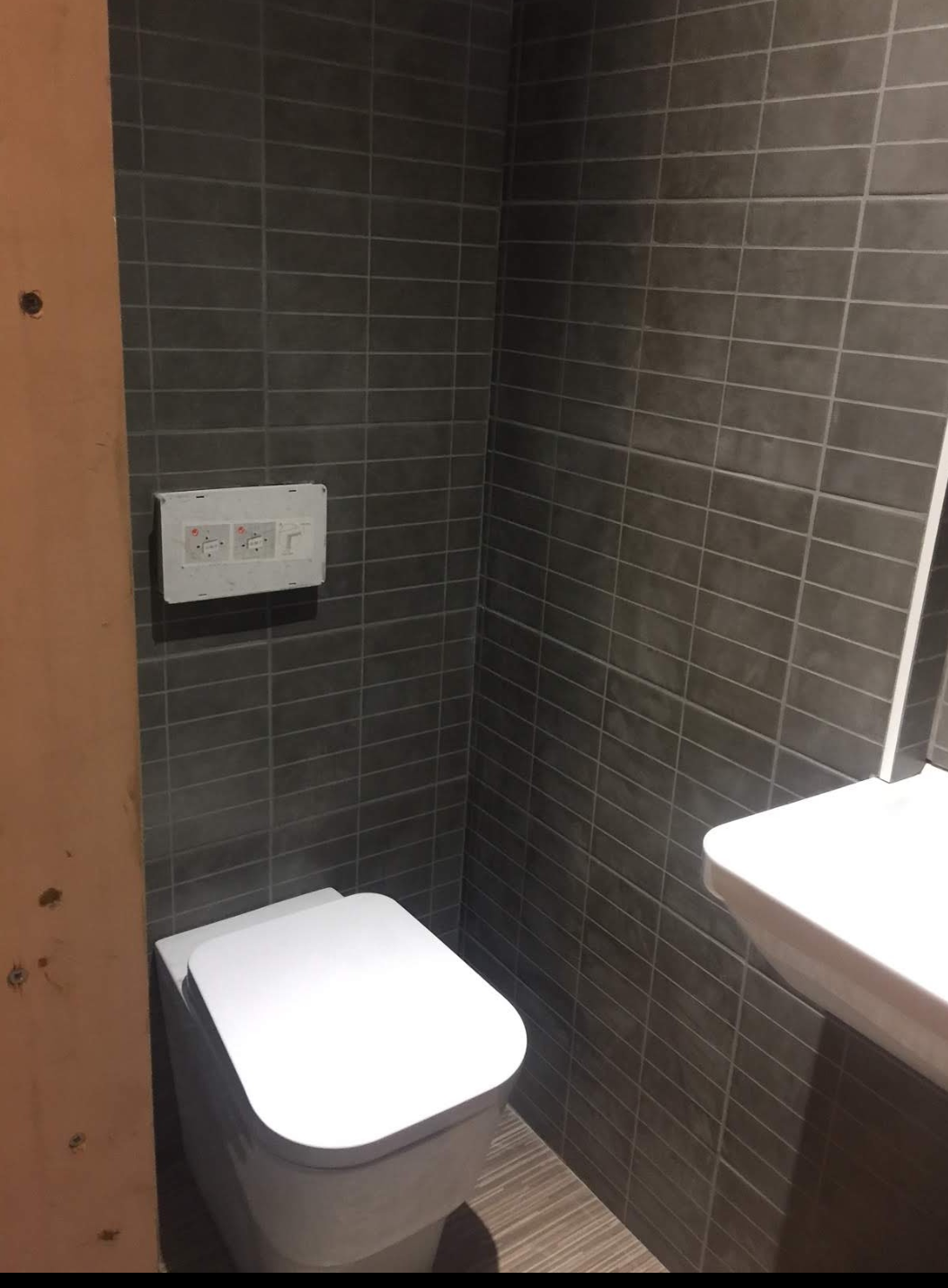

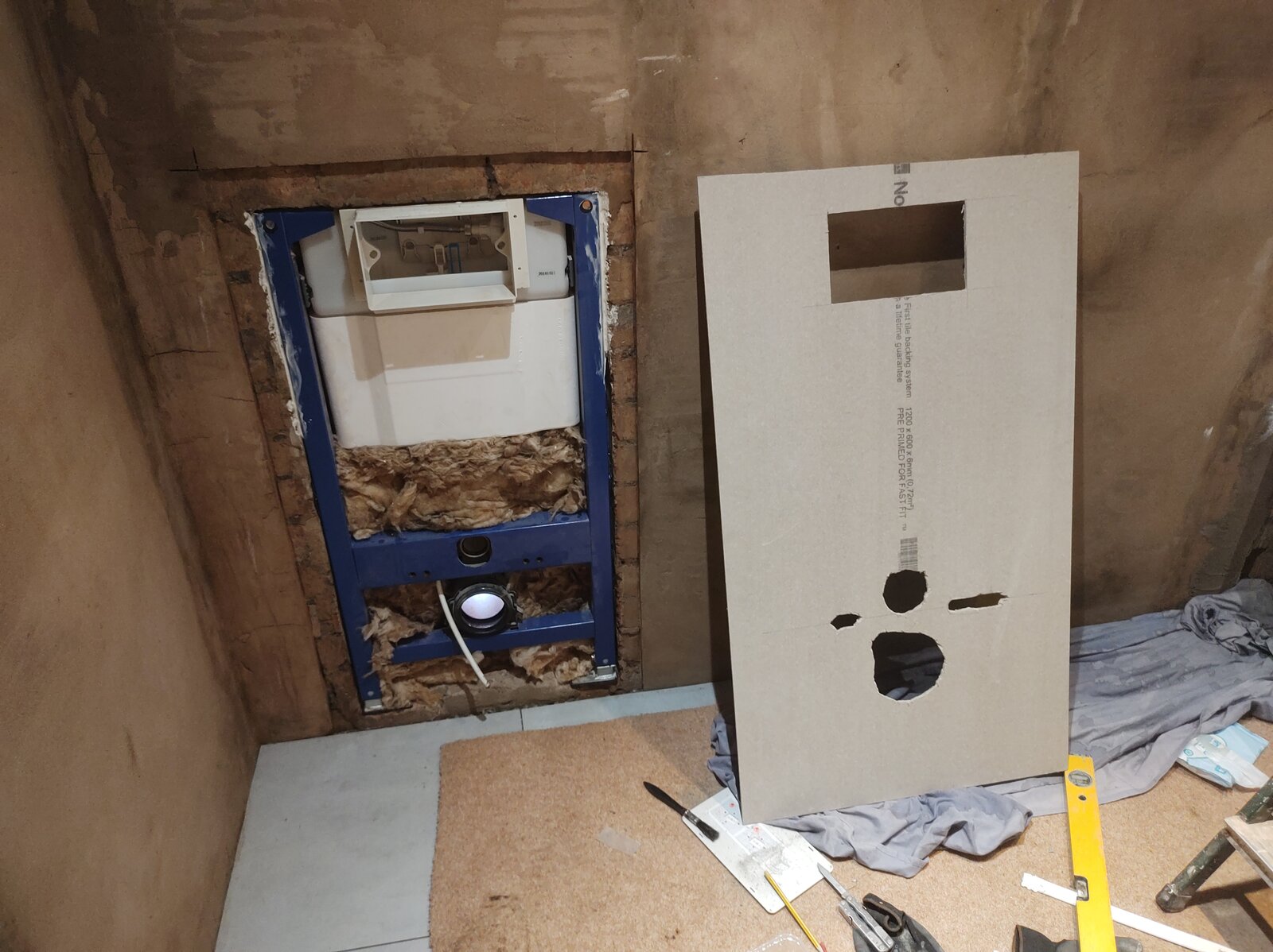

This one is a wall hung, in a cavity wall, so a bit more involved:
If you do fit one of these, make sure you relocate the isolation valve (see first image) from outside the cistern to the inside of the cistern before you tile it all over - all the contents of the cistern are accessible through the flush plate except the iso valve which comes fixed to the outside - with no access once tiled.
