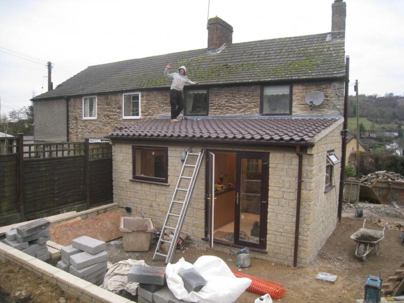

Is the highest point of that extension 2.5m?
No, it's about 2750. But there is scope to lower the eaves tight to the door head which would get you close. Also that extension is 3m from eaves to the highest point where you would be looking at 2m. If you could put the door in the gable wall you could go lower still. The ceiling would be e bit low close to the external walls but in practice nobody really ever stands that close to the wall. Anywhere away from the wall it would be ok.
