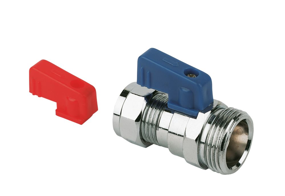

this might be better and will take mains water.
Yeah, I know that's the right device but the supplied fitting for the filter has a huge thread on it , the same size as a radiator valve. If I use the above I still then have to get the up to the correct coupling size which then requires another piece.
Unless the above comes in a 15mm->Radiator size coupling ?
