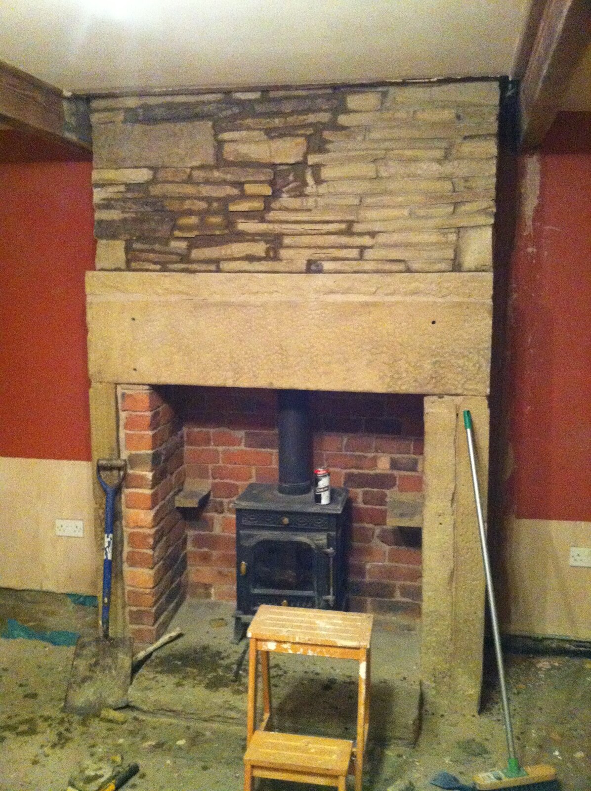

Hello. Im replacing an old stove which is 4kw. it never really got the room very warm. Its an old building with solid walls.
Ive run though the calculations for the size of room and its suggesting 6kw would be ideal. Id like to use the wood burner to heat other rooms, either by leaving doors open on using fans / floor vents so wondered if it was worth while going a bit bigger such as a 8 or 9kw or would this be too much?
I presume the only danger is that id get too warm? I had been considering direct air fed stoves only such as the exosy+ Panoramic 9 which is a 4.8-9.5kw fire.

This is the fireplace / old stove if it helps...
