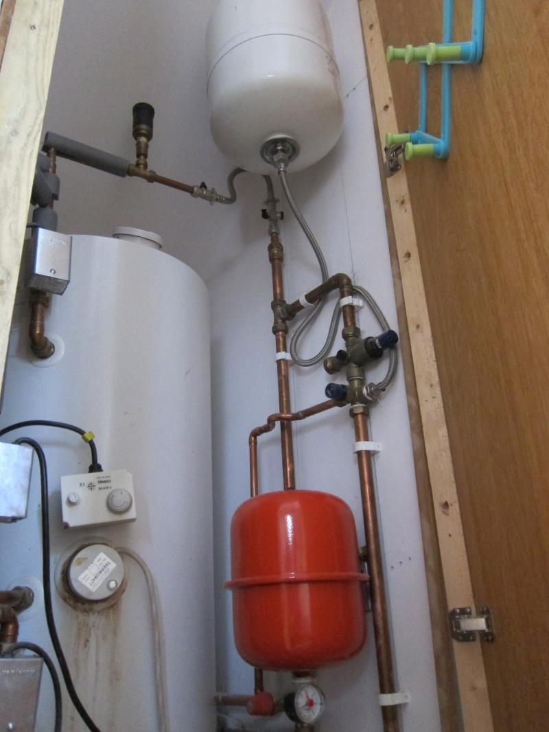

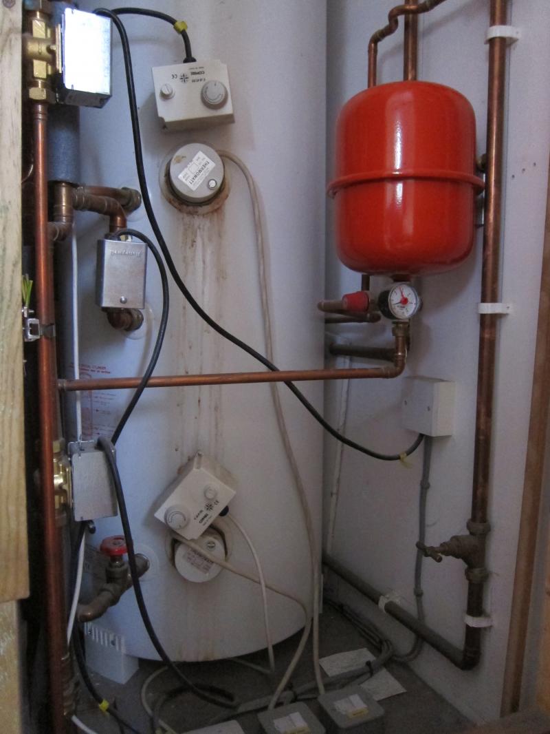

My unvented cylinder is losing pressure and needs pressurised a couple of times/week. Pressure drops from 1.5bar to almost zero over 3 days.

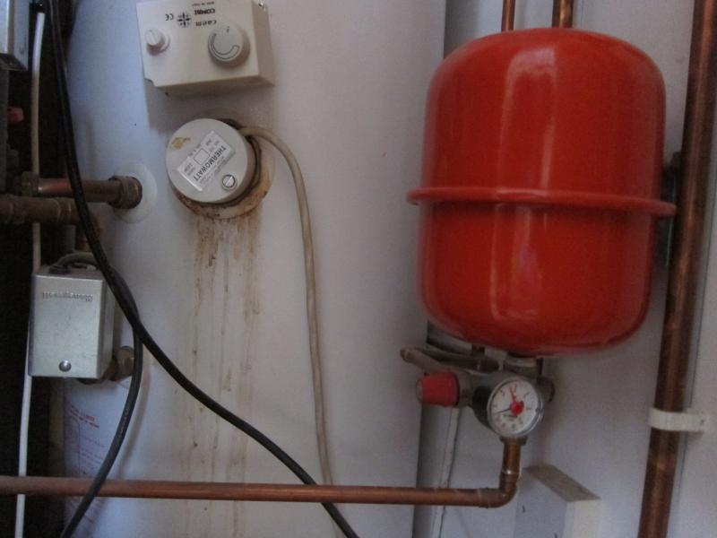

The thing is, I can't find any leaks and there's no evidence of water dripping anywhere in the house. There is a stain on the tank which looks like residue from a dribble but this has been there for many years and hasn't got worse.
There is also some evidence of a leak (staining, corrosion) on a boiler flange but no actual water.
Is it possible for a very small leak (which then dries up with the heat of the boiler/tank) to cause such a loss of pressure?
Could the pressure vessel (which looks like it has a diaphragm inside) loose pressure by having a leaky diaphragm?

Expansion vessel could have lost its pressure, or burst bladder, which means there is no expansion space so even the slightest loss of water causes a rapid loss of pressure.
By how much does the pressure rise between a cold system and a hot one

If it's on the expansion tank piping then it's the CH pressure. This will change slightly between cold and hot. With the CH system cold, note the pressure (should be between 1 and 1.5bar. Then bleed off some of the CH fluid - if you bleed off say a couple of pints the pressure should remain almost the same. If however it falls substantially then your expansion vessel air-side is either depressurised or the bladder is burst.

The pressure doesn't seem to change much between cold & hot. There are 3 zones; UFH, Upstairs Rads & Hot Water. No change in pressure when UFH running, or HW but a 0.1Bar rise when upstairs rads switched on.
I've added some pics which may be helpful.
