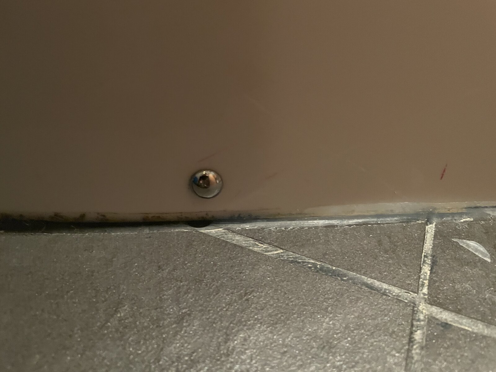

Hello,
Can anyone advise as to how to remove this Bath panel please?
It appears to have metal fixings, but they have smooth heads.
thanks

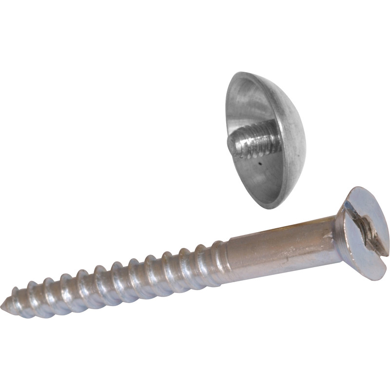

I may be wrong, but to me, those appear to be screw cap covers.
They may either pry off of the screw, or they may unscrew, in the same way mirror fixings do.
