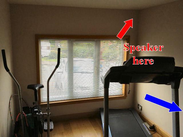

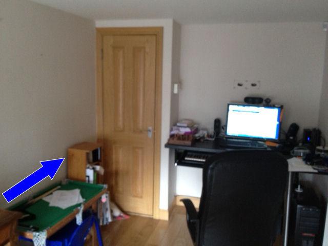

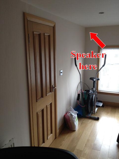

I would like to install 'surround' sound for my computer and would really like some advice on the best way to do it.
I want the surround speakers at the back of the room but there are doors in the way of running the cables back to the computer.
See the following pictures:
Directly behind me is the computer, you can see that the most direct path back to the computer the door is in the way on the left.
For the next speaker at the other side of the room there's a door to the boiler cupboard in the way of the path back to the computer
So... my questions are these...
What is the best way to run the cable? I would ideally like the cable hidden rather than surface mounted trunking. Could I just cut a 1cm wide channel into the plaster board and run from the furthest speaker back to the speaker at the back left of the room and then back, over the door on the left, and back to the computer?

Coving trunking will be available from your local electrical merchant. (May need to be a special order.)
Sam has linked to polystyrene coving which (a) dents as soon as you look at it with a finger - hateful stuff - and (b) isnt intended for carrying cables - although it often has a gap behind it and will 'do' for low voltage stuff.
Most importantly, the electrical trunking can be opened if you want to add/change cables at a later date.

John, you can use the normal rectangular trunking to hide these wires whether you use the plasterboard or the plastic cornice trunking. I have passed plastic trunking up though plasterboard cornice trunking into the loft and it looks OK.
John, if you get the MK catalogue you will see the full range of MK products that are available and there may be a pic that may give you a better idea of how it will look. B&Q sell the rectangular trunking but I doubt that they sell the plastic cornice trunking, but always worth a look, they sell the plasterboard cornice though.

As oldcardriver said, I was thinking of using the normal rectangular trunking. But, the more I'm thinking about this, the more I'm thinking about just cutting a small channel in the plasterboard and tacking the cables into the channel and then plastering back up.
The speakers I've got have RCA plugs on the end so I was thinking of putting flush mounted back boxes with RCA fronts on at the back of the room, then I could just mount the speakers and plug them into the wallplates.
If in the future I change the speakers I can change the front plate or even just put a blank on if I get rid of the speakers altogether.
What do you think about channeling out the plasterboard and running the cables that way? Is that acceptable??

I think that it depends whether you can do a nice job of filling the channel up afterwards to make it flush with the wall. You will probably need to do a lot of rubbing down afterwards to make it flat, if you do that then you are probably best using the sort of rubber rubbing block that they use to rub down cars.
There is some 11 wide x 8 mm thick plastic trunking which I would think is fairly unobtrusive, B&Q probably sell it with self adhesive backing so that fixing is easy. Here's the MK item:-
