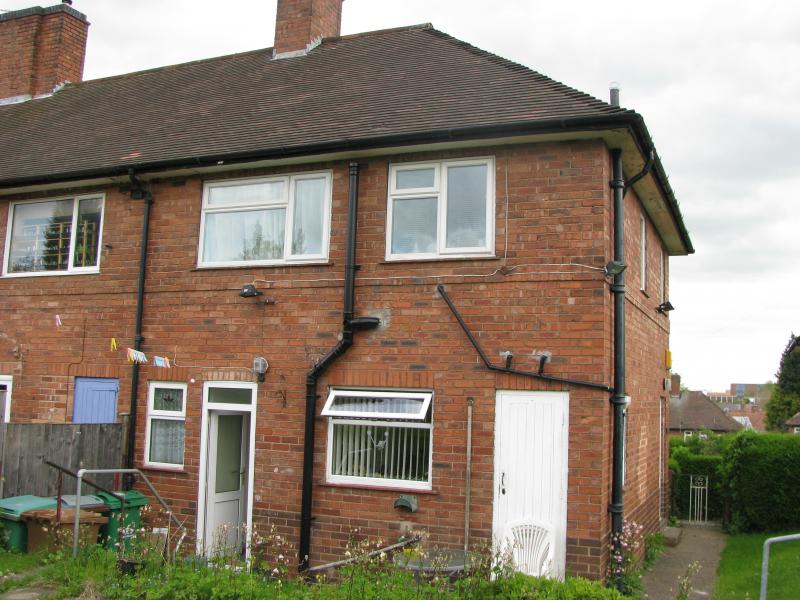

Right, I want to knock down 4 internal walls currently bathroom toilet and porchway.

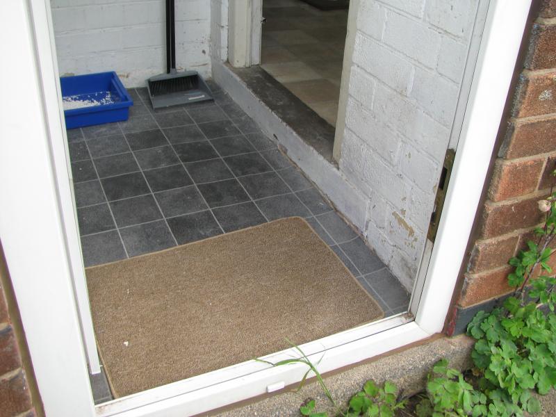

Im confused as to why there are two different types of brick - one red and the other a grey type.

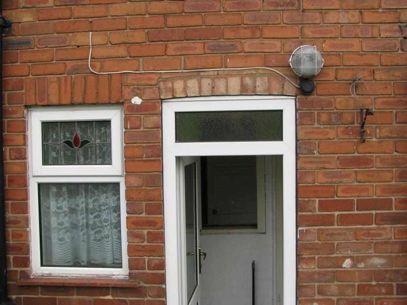

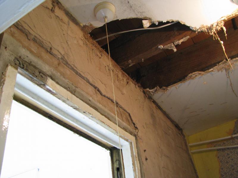

Above is the yellow wall to the far right in the middle. it has a window in with a wodden 'lintel' above
Also, where i have mentioned about the walls being different thickness'es

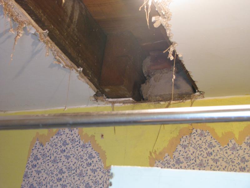

I removed some ceeling and found that above the wall come out to the same as the wall to the left

( on the far left where tri fold door would go the outer skin is red brick inner is the grey type.

I have figured out where the different coloured brick.
Originally there was no door in the porch bit so the red brick with window was an 'outside' wall

From what i can figure out: you want to remove most of the ground floor wall, including two window frames, and two doors?
And the internal walls of a ground floor WC compartment?
And then insert a folding door, and one new window frame?
Am i correct so far?

1. OK, you'r going to have to find the direction of all joists in the floor above.Go upstairs and lift floor coverings.
2. Any joists that rest on the outer wall can be propped from below, inside the room. The joist tails will support the brickwork above.
3. Any joists that run parallel with the outer wall or inner wall, then the wall has to be needled or "Strong-boyed"
4. Leave undisturbed as much brickwork as possible, esp. in the soil pie area. Dont go banging and smashing. Remove one brick at a time.
5. Only remove and re-build one wall at a time. Do the outer wall first.

One thing though, would I be able to put a catnic cavity lintel from the right hand of the pvc door (which is the proper width wall) and span it to above the little frosted glass window (which is not proper cavity below the brick arch but is proper cavity above.
With this though it means approx 30mm of the lintel would be over hanging the bricks below. but the bricks above would be sat correctly.
Hope that makes sense
Ref. holding up the outer skin, yes use strong boy's. i didn't explain that clearly. Difficulty is, giving this kind of advice over the web, a number of "best" decisions have to be taken there on site.
At the least, you will have to install a drip hood above the door frame. Security and the sill arrangements must also be looked at.
I dont understand the catnic business - are you saying that the outer skin brickwork at that point recesses 30mm? Surely not. Any discrepancies on the inner skin can be dealt with reasonably easily.
Hi, no its not the outter skin that recesses, its the inner, but from the 2nd floor up it comes back out to standard cavity.
I presume you can not have a lintel across 2 different thickness of wall as all the inner half of the lintel will only be sat on half a brick if you see what i mean?
