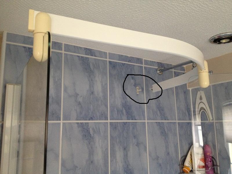

Hey folks, I wondered if anyone could help identify this shower enclosure;
We bought it from B&Q years ago! (prob about 10+ years ago)
Basically, reason I ask, is in the 2nd picture you can see the bracket is broken, It seems to be one big bendy bracket (plastic) so I wondered if it could be bought as a single piece to repair.
Alternatively, where it is broken off, is actually a joint itself, so I guess a similar size bit of plastic with the correct holes would fit.
Any help would be massively appreciated,
Kind regards,
Sean
You could repair with a angled bracket at the wall fitted so plate sticks out from wall and fits inside rail then secure with self tappers.

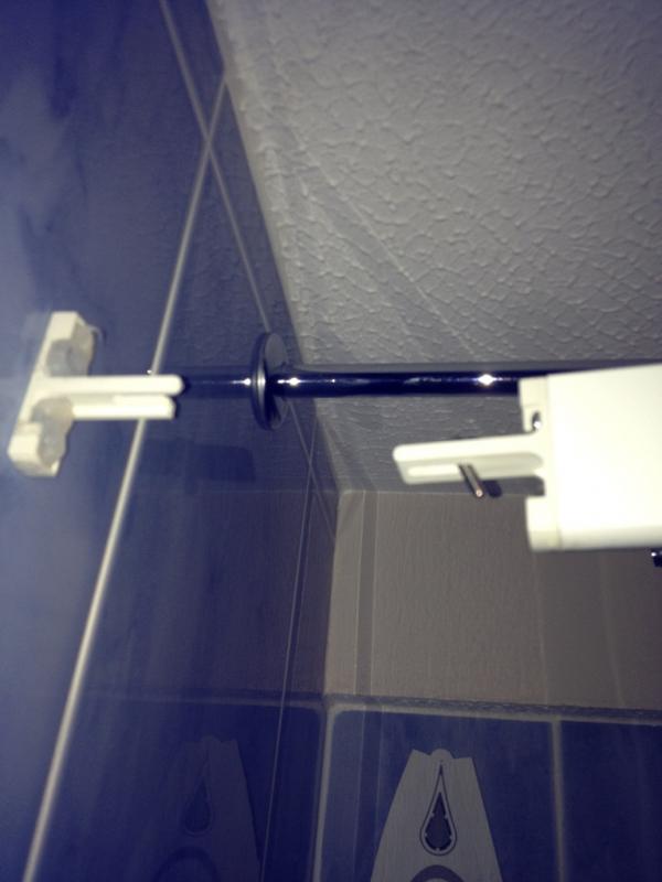

Hi, I just took a close up if it helps,
You can see, the part going into the wall is screwed in (once that glue stuff comes off you can see the screws) and also the other end has a slide-type thing that I guess gripped on to the other side and was then tightened together.
It was a couple of years since it broke, I should have kept the part but typically didn't!
