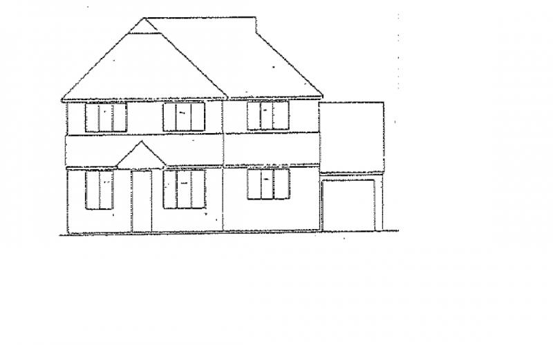

Here is my house at the moment, so the right hand side bit next to the garage is the extension. I am looking to do a hip to gable on the left and the right, although the left is the original house and the right is the extension, can i put a hip to gable on an extension as PD ? And i'm told i have to take into account the additional roof space that has been created on the extion side into the 50 cubic meters allowance ?

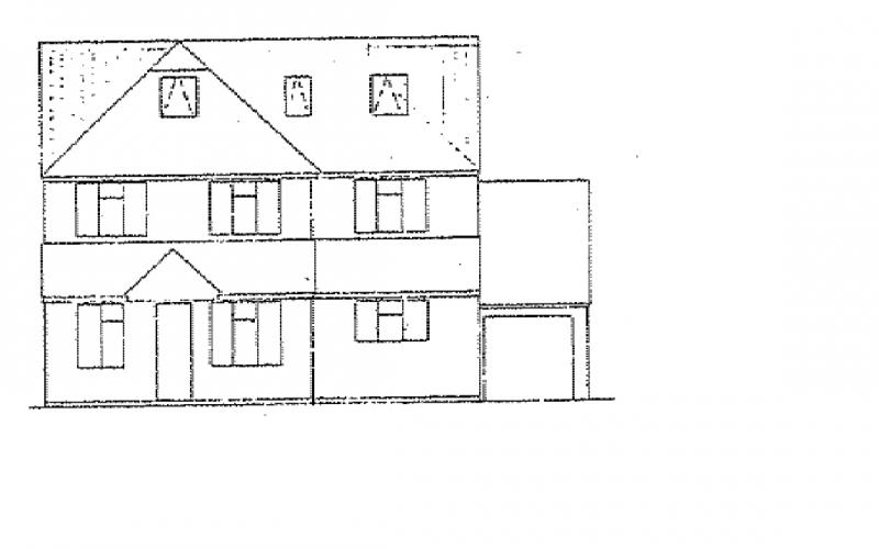

Here is the proposed.....so changing hips to gables on the sides ?
Question 1 - In the 50 cubic metres allowed under PD, do i have to include the additional roof space created by the extension on the right ?
Question 2 - Am i allowed to raise a hip to gable on both sides, or more importantly am i allowed to do it on the extension side on the right as this is the side i'm unsure of as it's not the original house ?
Question 1- as has been said twice, yes you do have to include the extension roof space in the 50m3
Q2- I think you will have to talk to the planning team at your LO, as Tony has said, there is a chance that it wont comply to PD due to the extension, (but not because of the reason that you think)
1. Yes, it is the total additional roofspace to the original dwellinghouse, so that would need to include the extension roof volume.
2. I believe that the hip to gable alteration on the extension would require planning permission.
