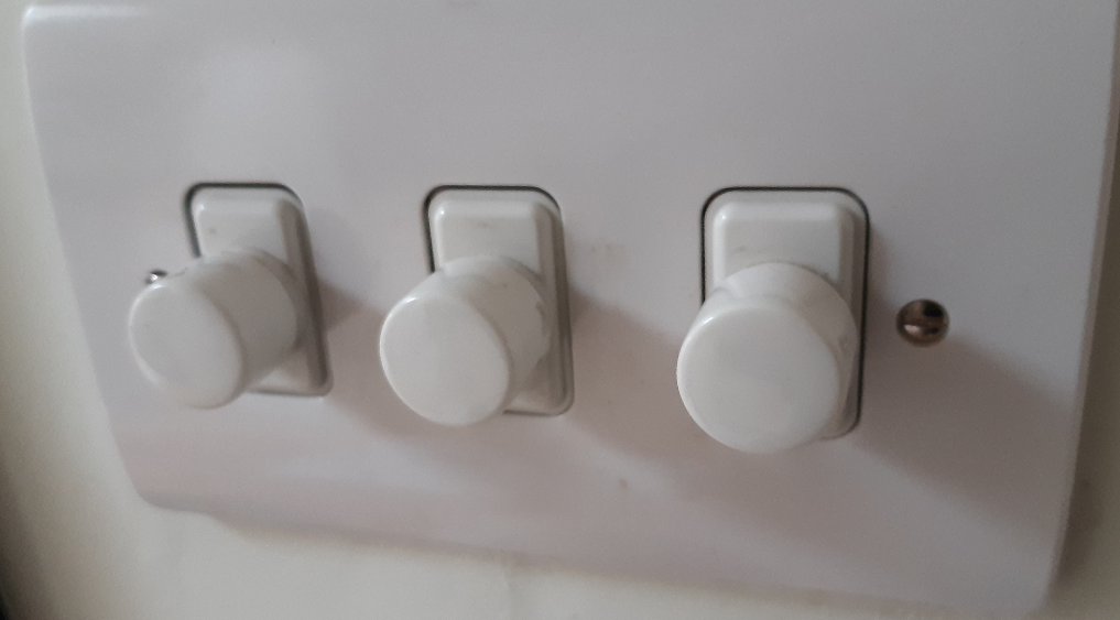

Hello
I'd like to replace this with 3 normal on/off switches
Presumably I can buy 3 new switches to replace the dimmer modules but can anyone let me know the make/model I need please
Alternatively suggest a standard 3 switch replacement (needs to be double width like this)
Many thanks

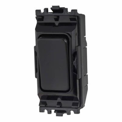

All Mk grid stuff is interchangeable, so apart from White you can fit other style switches and also replace the front cover.
For example you could fit a Black nickel faceplate with black switches, or silver even chrome.
Likely less than £10 and not much use nowadays as they likely will not work with Led lamps, sorry:)
I think the OP wants to get rid of the dimmer modules (and sell them on eBay!) and replace them with ordinary switches.

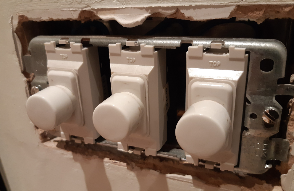

They look more like the MK ones to me...
Actually they might be, i was going by the knobs, I was sure Mk had chamfered and thinner knobs, but Google images suggest they dont now.
My pic was just a random pic of one such clone that fits and as you noted the white bit has a different profile.
(Cue, Securespark with his OOH MATRON comment)
I don't recall MK ones having a 'top' marking.... a good tell seems to be the colour match of the plate and the module... in the case of my Varilight one.... bad.
The one the op linked to is Mk and has the knobs i recall and does indeed have TOP on it
NEWER MK seems has normal knobs
