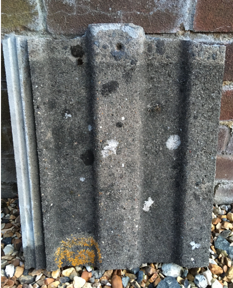

Can anyone identify this roof tile please ?
27 Jul 2006
447
8
Now i know its a Marley as its stamped on the back but the top of the tile is broken off so i can't take an exact measurement
That said, its 332mm wide and +412mm (the broken length)
So can anyone confirm that this is a Marley Ludlow Major please ?
2nd question.....
I'm looking to replace one of these tiles with a built in vent to duct the steam from an extractor fan over a shower
Can anyone confirm a good manufacturer of tile vents please ?
Thanks in advance as always (y)
Ludlow Major
You want a roof terminal not a tile vent - unless the vent can act as a terminal too. Klober,Ubbink, Glidevale are common.

Woody, thanks for the reply !
Can you confirm that if it mentions "....or mechanical extraction", then that means it is suitable for an extractor fan please ?
