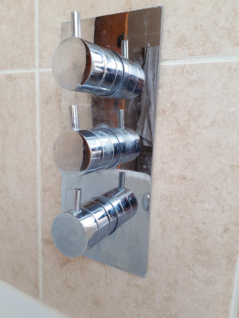

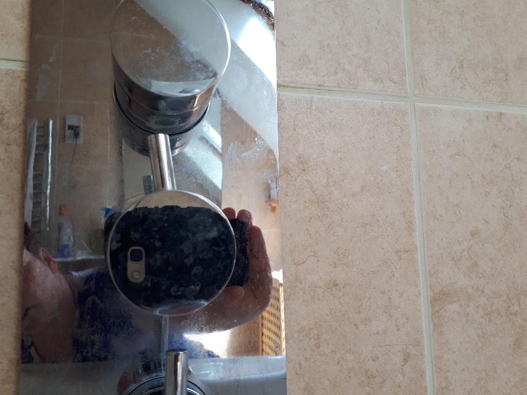

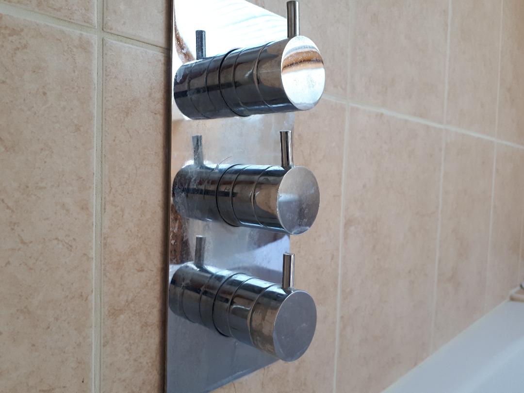

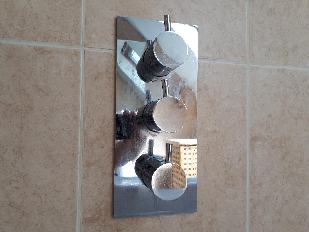

Can anyone identify this shower/bath control? (end my nightmare)
5 May 2018
2
Installed following a house fire in 2007. It's a vertical unit with three dials which I think is called a bath shower divertor. There's no brand name on the dials or front plate. A plumber has tried to remove the cartridge but it was stuck and then had to be tightened after something was leaking. He has taken photos but we have not heard any news back. Now have no hot water supply reaching the bath.
Top dial controls shower on/off.
Middle dial controls the temp. Left arrow for hot water. Right arrow for cold water. Arrows are marked on the backing plate and not the dial.
Bottom dial is bath on and off.
Each of the dials is made up of three metal rings.
Erm,does not sound good (n).
can you take off the 3 handles and rectangular cover plate and photo the actual brass (hopefully) concealed valve from left.right and front. The valve will be a fairly generic item,the handles and rectangular cover are made in many different designs. Fitted a bristan prism yesterday and it had a choice of 10 different handle/front arrangements.
Which cartridge,what is the fault ?
your photo 1,are the handles always in that position when not in use ?
was there ever any markings on the handles/rectangular cover ? they may have worn off :!:.
should be an easy repair but consider how much the parts will be compared to the cost of a new complete valve :idea:
