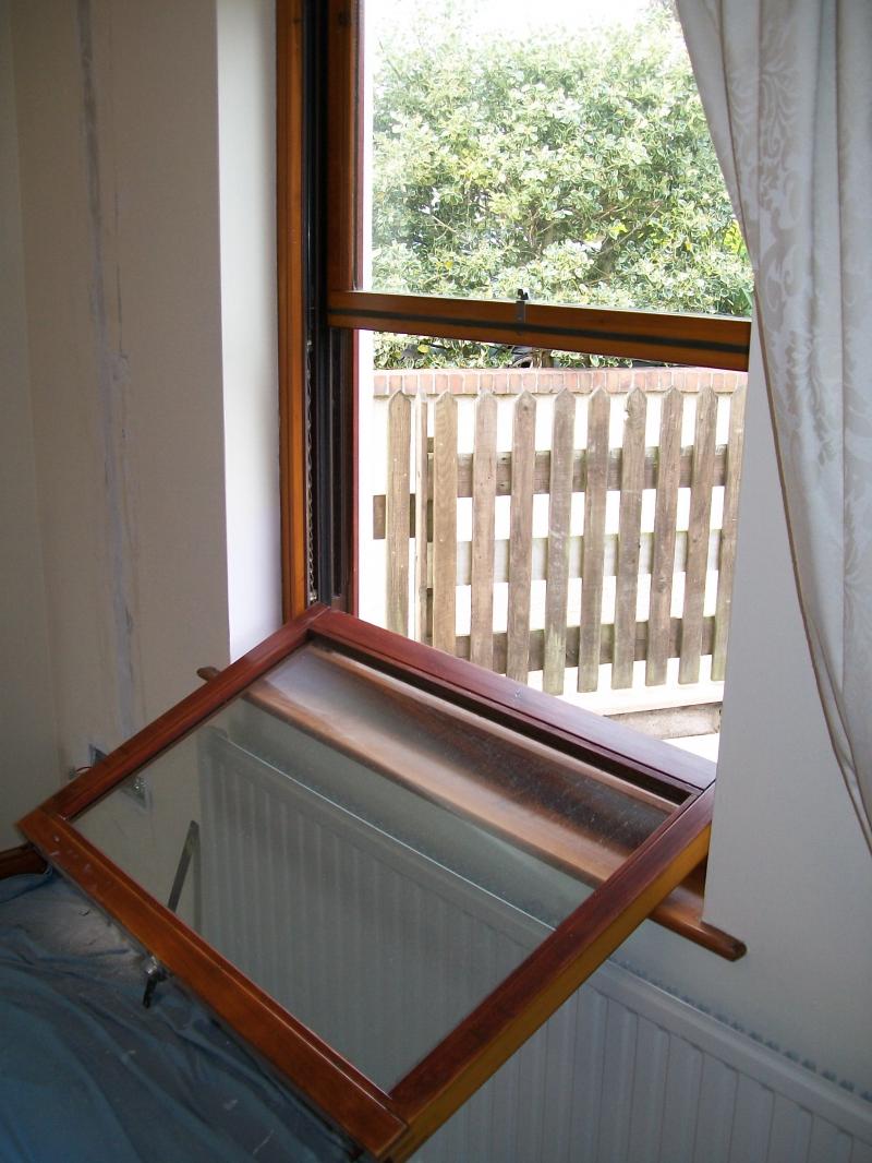

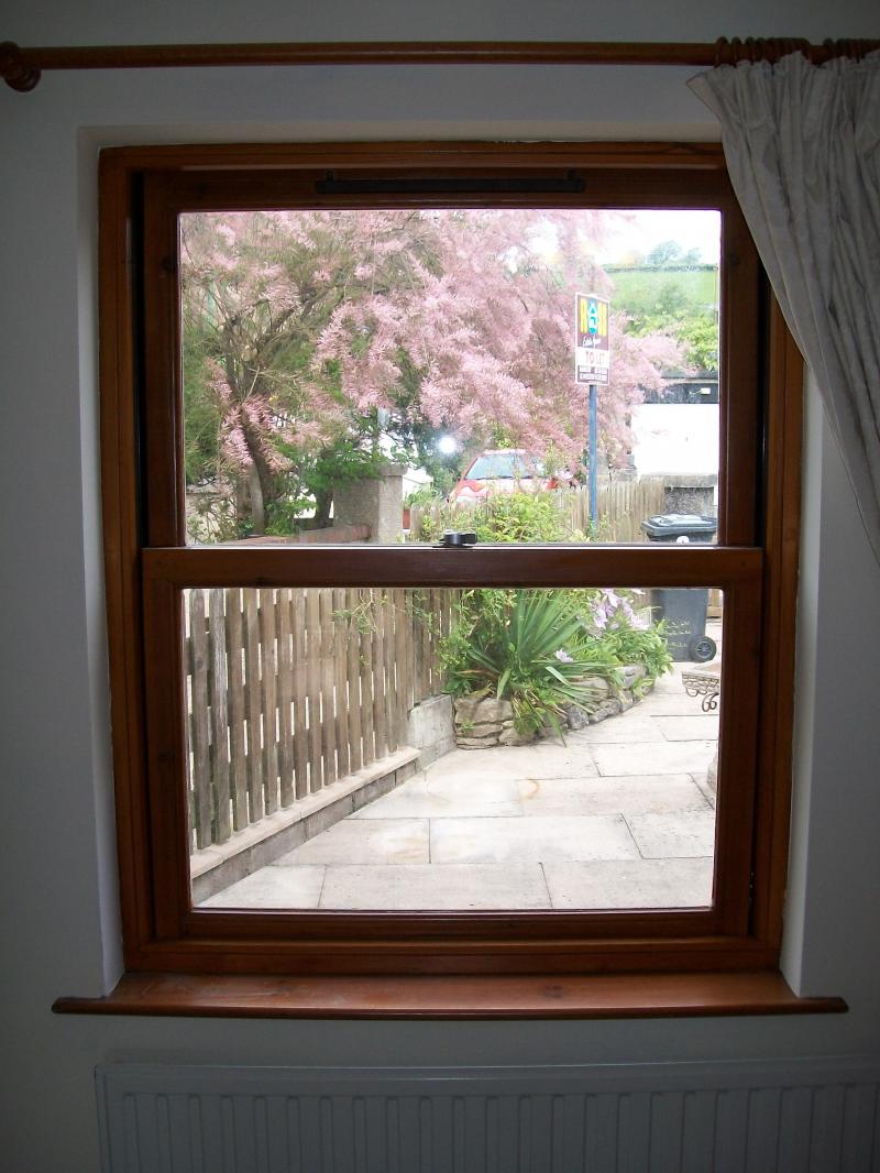

In my house and flat I have these sash window units, but several of the spring units have failed and I suspect others are probably not far off. Can anyone identify what they are so I can contact the manufacturer for spares ?

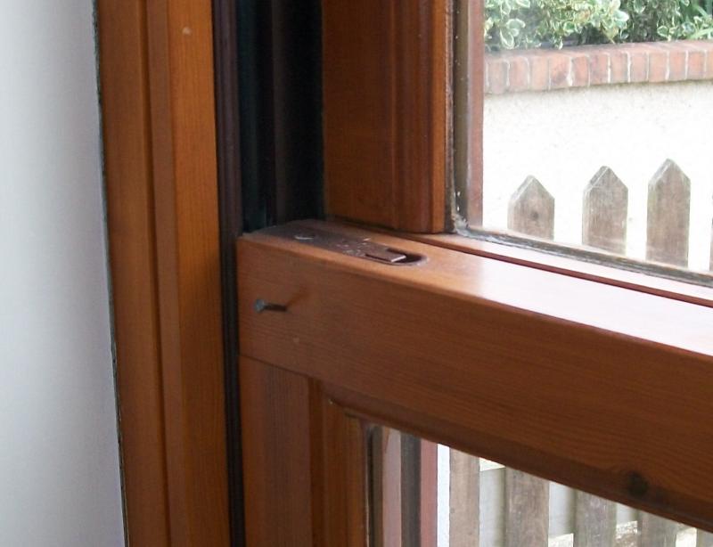

The catches on the top of the sliding unit lift up, and then the unit can hinge down. It can also be removed at this stage by lifting one end until it disengages from the slider.

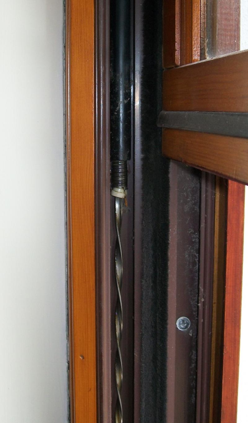

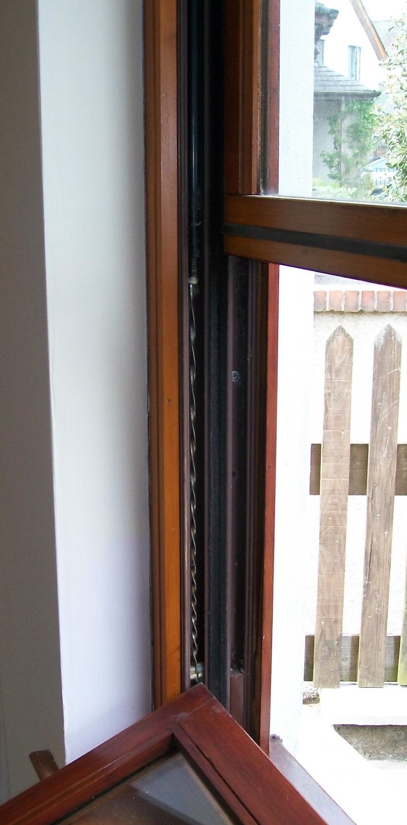

The torsion spring arrangement that stands in for the older style of counterweights.
Theres a whole host of different tension springs, all colour coded, different sizes/lengths so you're best bet is to contact some suppliers.
Just google 'spiral balance' to find a supplier near you

Thanks God and crank39, it helps when you know what they are called. I've never seen them before and assumed they were something oddball that I'd struggle to get replacements for. Time to whip some units out and weigh them.

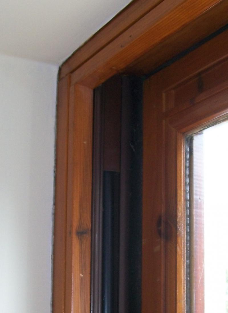

I do have another question, and it's about fitting.
There are bits of plastic (which I know know are called stops - fairly obvious really :rolleyes:). It looks like these are moulded and have a closed end so they won't slide (down for the one pictured) to reveal the fixing screw, and they seem to be slotted in - it looks almost as though they were slotted in before the frame was assembled. Any suggestions how they are likely to come out ? I've tried a pry bar under the open and and it was just splitting.
