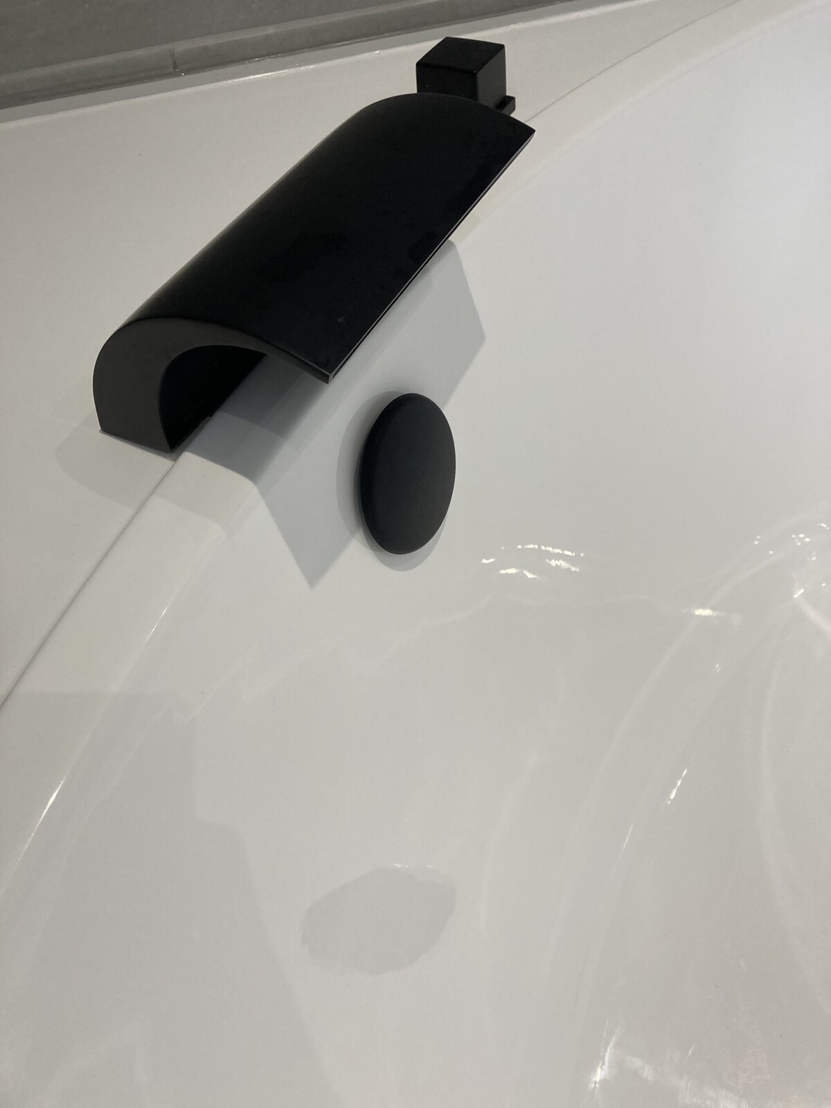

Hello all,
We recently had a bathroom redesigned and during the process the stop clock was turned off and on several times. The flow rate on the taps now has increase massively (the whole house not just the bathroom)
I believe the stop cock was only partially open before we started closing it for the work.
Is it safe/the done thing to only partially open it to control the flow rate out of the taps to a manageable level?
I wouldn’t normally mind but the kids in the house open the taps fully and makes a mess every time
thanks is advance
If you look at the spouts of your taps I think you will see a screw-in (usually plastic) aerator insert.
You can take these out and screw in water-saving ones that reduce the flow. Your water co may send you some free. Or they are on Ebay, Amazon, Green/ecological sites. If the taps are fairly new the tap manufacturer may sell them. Do it before they get jammed in with limescale.

So, looking back to the stop cock issue, would it be safe/possible to throttle this to better control the flow throughout the whole house rather than fitting individual restrictors to taps? Thanks
You can if you want, though I think it's the "wrong" thing to do.
I think that when extra water is drawn, e.g. flushing a WC, washing machine, hosepipe, the pressure will drop and your shower flow and temperature fluctuate. People spend a lot of time and money trying to get good flow.
If you are in an area with unusually high water pressure you can get a pressure-reducing valve.

BTW if you send off for those free tap inserts, you may fix the prob in a trice.
Will never get one on this bath tap though!
